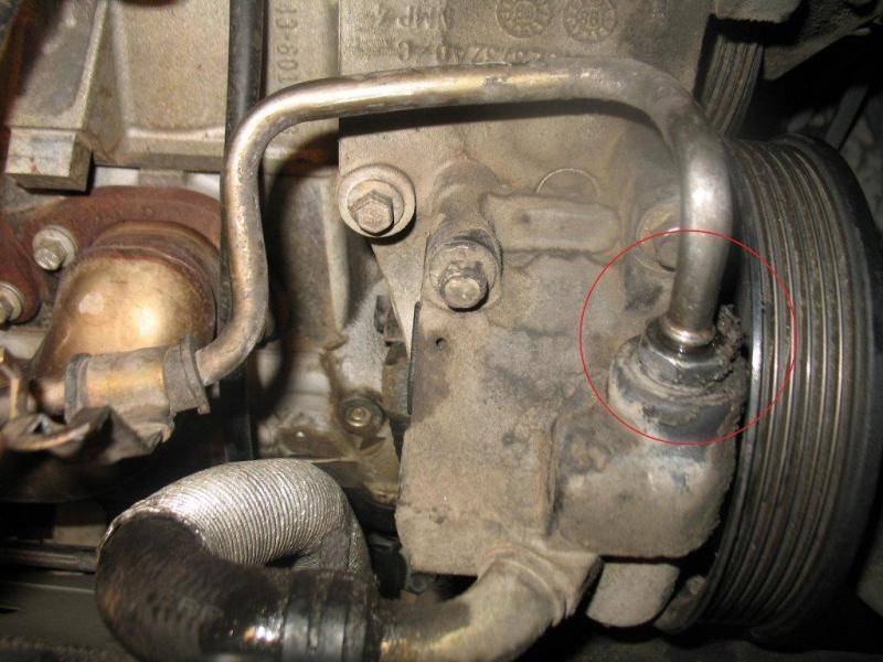

Was replacing my A/C compressor and trying to fish it out of the car (which was a major pain) and in the process of pulling it out I believe I caused a leak at this Power Steering fitting between the tubing and the nut itself.
Questions:
1. Should the tubing that goes into the fitting twist?
2. Do I need the lincoln part for this or can I fabricate one of these using a flaring tool? I noticed it is not a standard fitting it must be a 18mm size.
3. Getting the A/C compressor out was a major pain. How do i snake the compressor in without messing this line up again when i replace it and reinstall the compressor (the hoses below get in the way)?
Thanks,
Kool LS

1. Yes, it should rotate in the fitting with little effort.
2. I would get the correct part. Due to the way the hose spins freely, it probably can't be done with a standard flaring tool.
