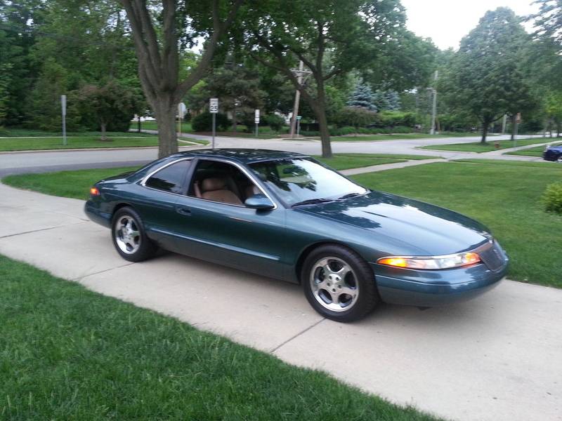

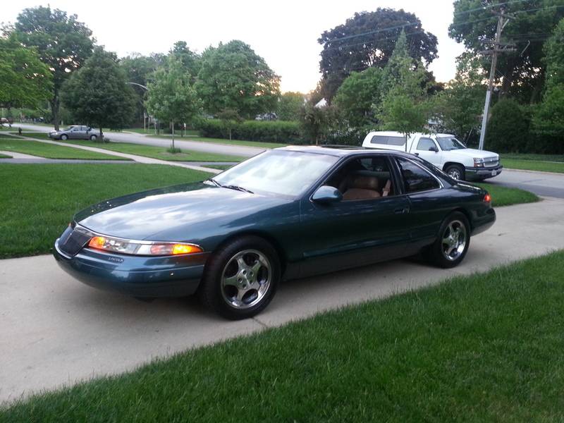

This still drives me nuts. Fronts are equal @ 26", RR is 26.5", LR is 26. Drivers side rear fender is flush with the top of the tire, I can fit a finger in the pass side rear.
Both rear irs bracket mount bushing have been in various states of junk with no effect on height.
The drivers side rear has always been .5" lower, I'm almost certain it was the same way when I was on air. No amount of adjusting equals them out. If I raise lower one side or the other the opposite side will do the same.
Any new insight? Still trying to convince myself this is normal. :(
