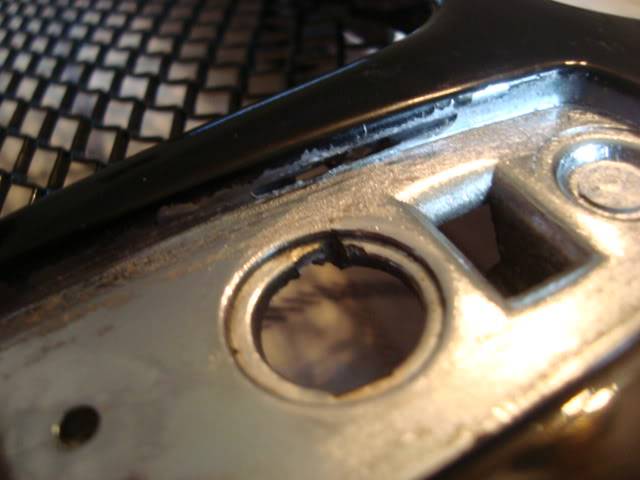

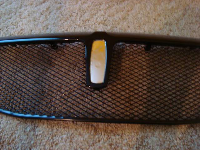

Started off with the black and chrome emblem but I used paint stripper to take off the paint then added black paint in the inside..
Added a reflective tape behind it.

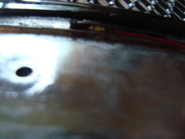

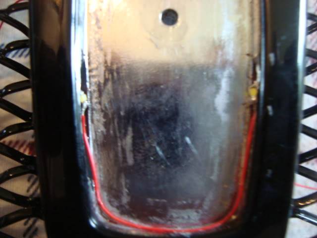

Dremmel'd slits in the sides to fit the LEDS

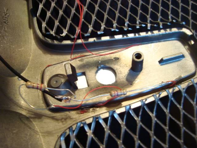

wired in parallel
Took me about two days but that's just cause I had stuff to do.. I DONT think ill be doing the back.. lol its tough work working and soldering LEDS this small..

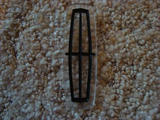

Kinda what I had in mind but painting the emblem and leaving the lincoln star clear. Then putting LEDs behind that so the star would glow.
Either way, looks awesome!
Im thinking it would look better with the clear/black parts reversed. Either way, thumbs up for the work.
+1 on painting the emblem, i remember talking about it but it actually looks better then what i though it would, pics on the car yet?
Probly wont have pictures on the car till later this week, got some halo's coming in will wire them up when they get here as well. Also now that I look at it.. I think I might just take it off and change the color scheme.. Thanks for the tip

think they are 0603 or something like that, they go inside xbox360's that's were I got them from. I am reversing the colors right now. Ill post pics up later with a night shot too
