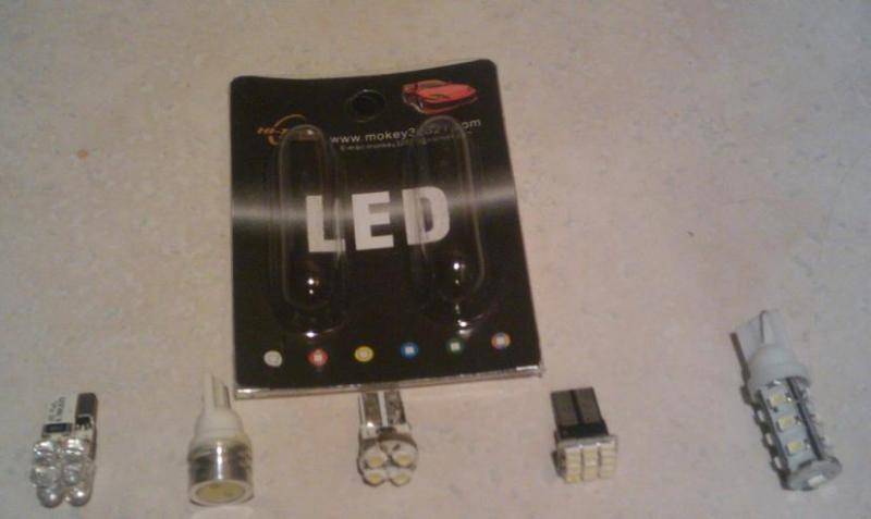

Don't have any installed pics, but I have attached a pic of some of the different LED bulbs I've tried. They're all T10 (fits 194/168 bulb sockets) eBay China specials.
From left to right:
Non-SMD LED - these suck, and are useless unless you need about 1 candlepower of light. They're also narrow angle, providing more of a spot than a flood of light.
Large SMD - All these SMDs are wide angle and thus good replacements for incandescents. This particular large SMD puts out about as much light as the next 4 SMD.
4 SMD - These are about $1/ea shipped, and are a bit brighter than your average incandescent.
15 SMD - Very bright, good for map lights.
13 SMD Cylindrical - The brightest I've tried yet, as you would expect, these throw a bit more light around the side of the bulb than the end. They get a bit too hot for continuous duty IMO.
As far as color, sometimes you can specify what shade of white you want, sometimes not. Most regular white LEDs do have a tiny bit of a blueish tint to them, sorta like a 5000-6000k HID.

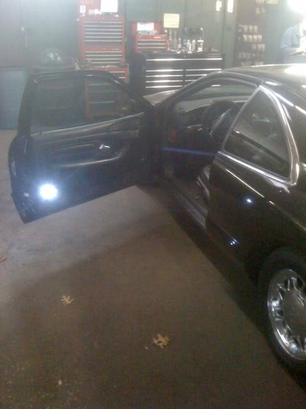

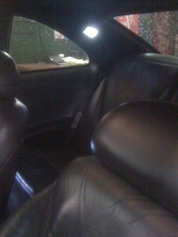

Was going to get pics last night but had too much work to do, once I get a bay open I'll pull it in my shop and get some pics

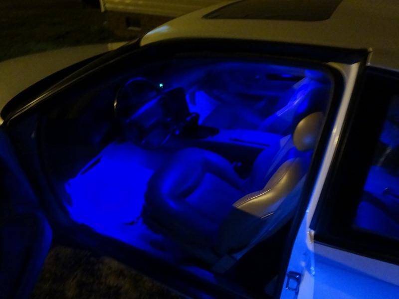

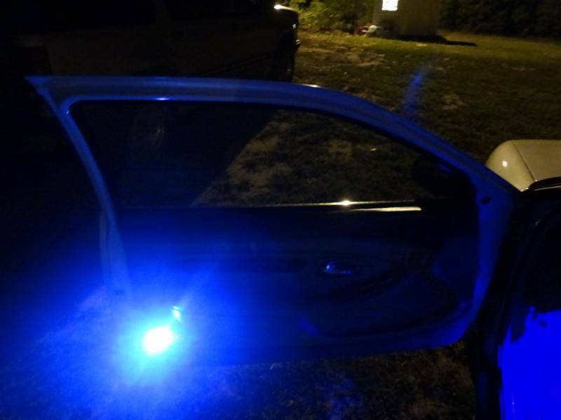

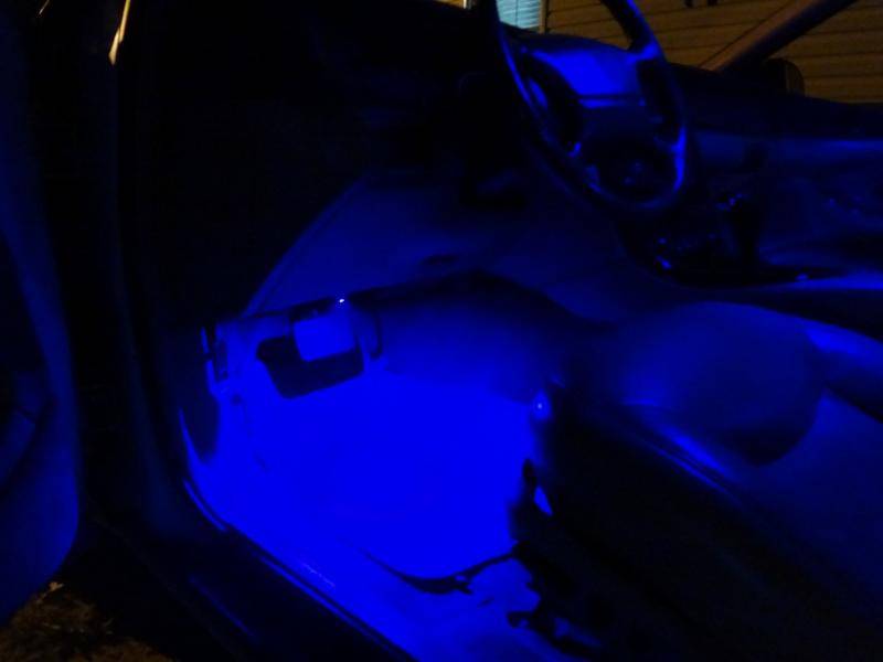

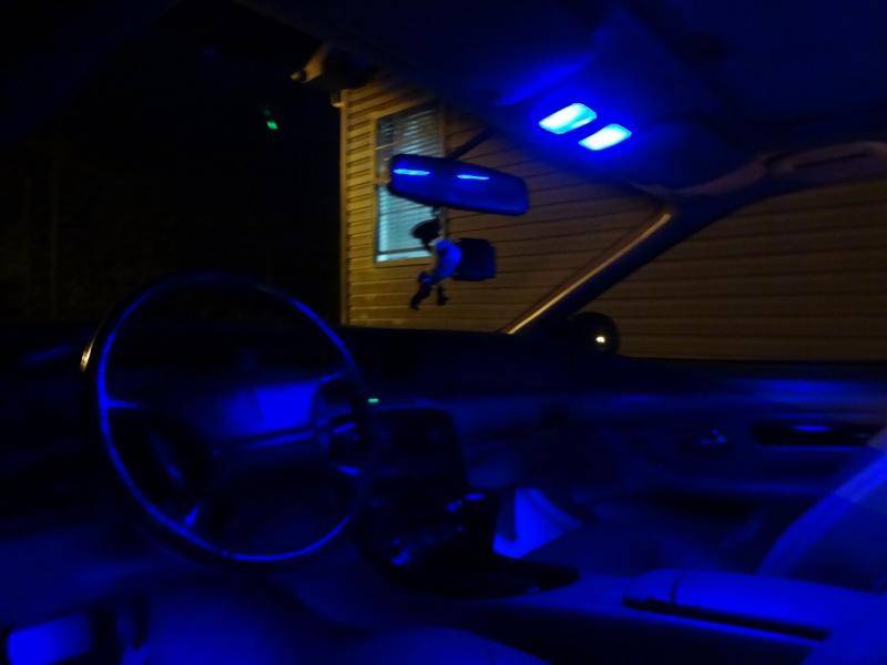

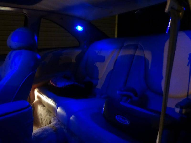

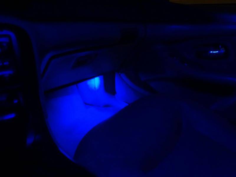

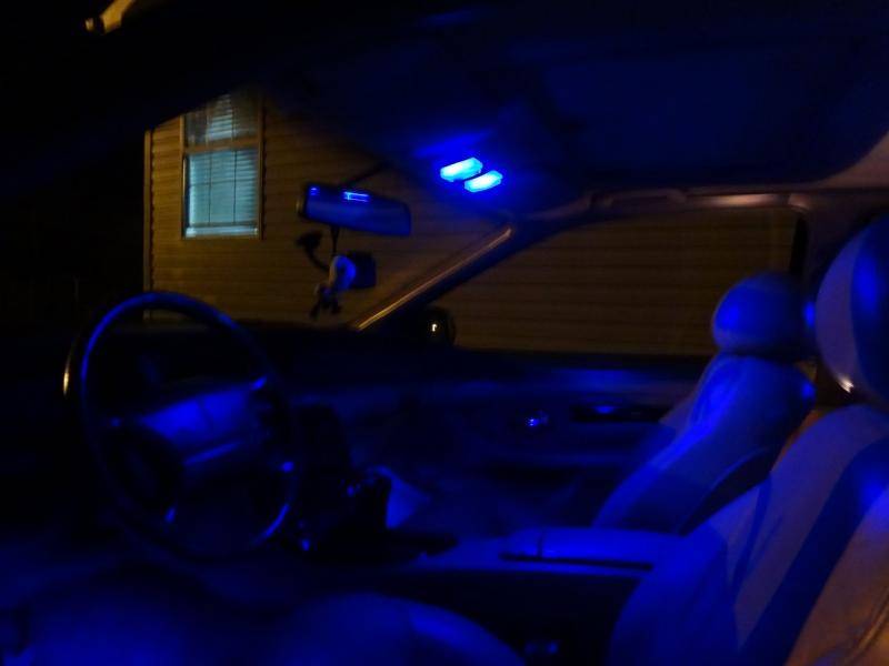

ill post pics when i get back to my phone, they arent great tho, because they were taken with a phone

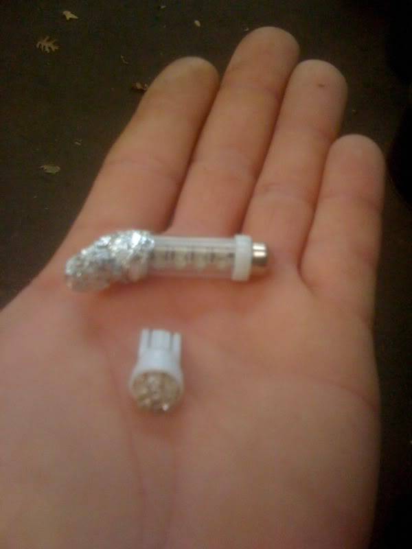

8 bulb in the doors, 7 bulb in everything else. Sorry the pics kinda suck
More importantly do they do the theater dimming thing. If so we need details video would be super nice.
yes, previous owner installed the lights, used foil on the doors bulbs for better connection
