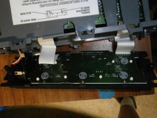

went to change the eatc lights...no luck
removed working orig bulbs, put in new led's (right size base), no light, put orig bulbs back in, no light, put tester on led's they work, checked dash fuses, all good, put volt meter on eatc pcb - no voltage; wheel light works, display works, eatc works...no button lights
any ideas?

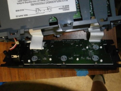

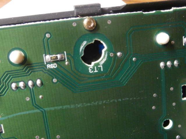

Lets see some pics of the board where the lights go!

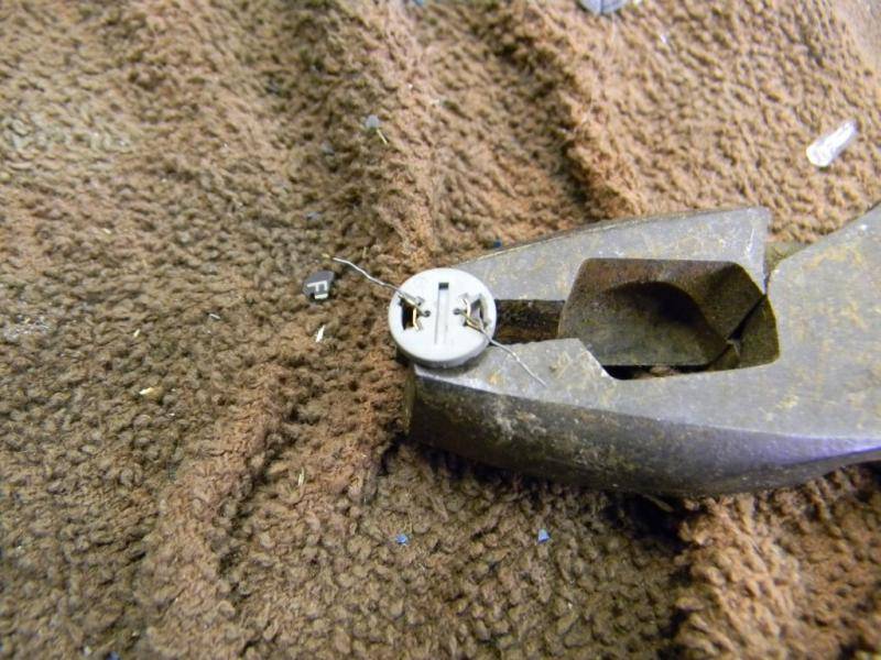

My button lights were not t4's but something else! I had to re-solder the new led's into the original socket in order to get them to work. If the rest of your eatc is working correctly then the problem lie's somewhere around your button light area.
what's confusing is the orig bulbs don't work either,
this is an extra eatc, same as the one in my 96

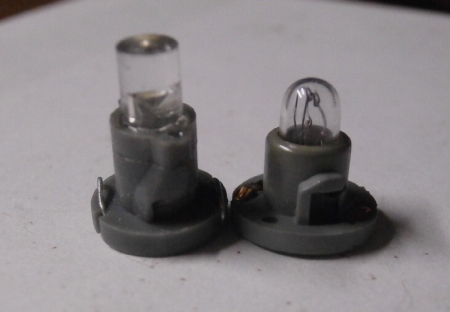

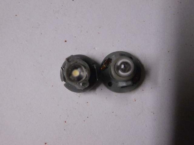

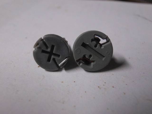

You got the wrong bulbs. That's what I was saying..."I had to re-solder the new led's into the original sockets"....(so they would work).
Last pic....left bulb works from the back of the circuit board....right bulb works from the front of the circuit board....see the connecting wire?
You have to make your own!
2nd to last pic....square bulb works from the back, round bulb works from the front....You need to take the square bulb out of the socket and re-solder it into the round socket! Then it will work as long as you have the polarity right.
