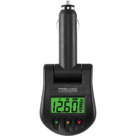

Can you please suggest how I can check the voltage while driving down the road. Especially when stomping on the gas. I can't think of how this could be done. Thank you.
I am going to bet that the "new alternator" isn't Motorcraft. Aftermarket alternators don't work with the 1st gen LS because the 1st gen uses an unusual alternator control strategy. It has been discussed, a lot.
It was put in by a shop and it is a remanufactured alternator. I don't believe it's motorcraft.
Easy, connect your voltmeter to one of the power ports in the cabin. (There are lots of cheap plug in ones available if you don't want to wire yours to a plug.)
Then you know the answer.
http://www.walmart.com/ip/Equus-Innova-3721-Battery-and-Charging-System-Monitor/15137663
