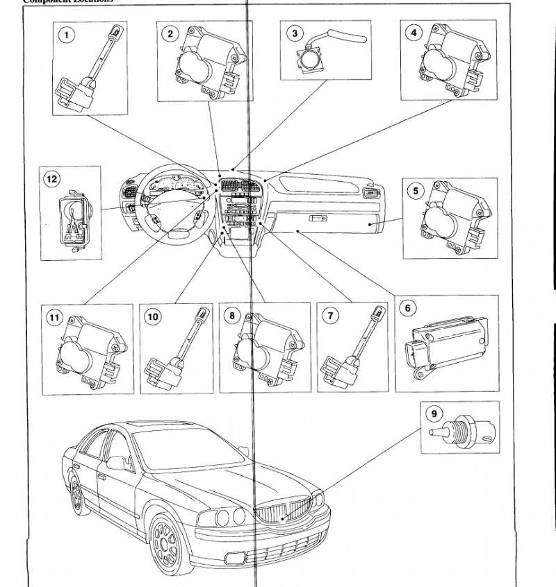

could not locate the sensor under the drivers side. Wondering if this is located in the same place for a 2000
This is what I have.
okay, looks like dash needs to be removed to get to it I guess I will get that done tomorrow. I really appreciate your time and posts this has been an ongoing problem and I have put so much money into trying to get my ac fixed.
having trouble removing dash to get to evap sensor. Any suggestions. Also I cannot find the sensor online or the pricing of it. Please help.
TascaParts.com. They have sensors listed but part number search on website shows zip. Try calling them, they have been very helpfull to me when I had questions. Good Luck
I'm really unsure of where the sensor is located. I was told it was under the dash on drivers side next to where the radio sits. So do I need to remove entire dash or can I just remove center?
I'm not sure, but you'd have to remove the center parts (AC vents, radio, DATC, ash tray, ...) before removing the rest of the dash anyway. I'd start with that.
finally found the sensor, only thing is there are 3 identical ones.....which is post evap sensor? Top middle bottom
The top according to the diagram above. Unplug it and run the diagnostic again.
