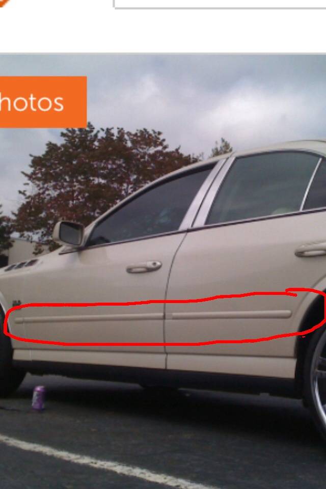

I am curious as to how the exterior molding along the entire side of the LS is removed.. Does it need to be done by removing the door panel or can it just be pryed off with no damage to the molding itself?
Which molding are you talking about? Rocker panel moldings AKA side skirts or the molding/trim on the doors?
Added a photo no matter which I write down for searching for the parts something different comes up it's the molding/trim
use a hair drier to heat up the two sided tape then pull as you heat, comes right off
Haha not my car I would never put those vents on it just a pic I found online thank you
Dental floss or fishing line can also be used to 'help it along' if the hair drier doesn't work quick enough
would be cool to take those off and paint them. how do you put them back on?
