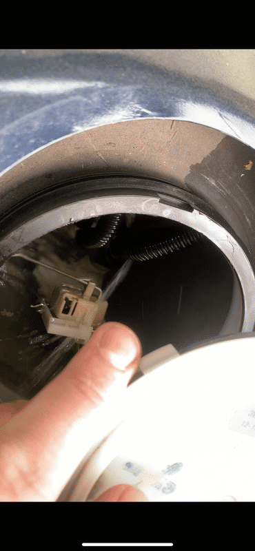

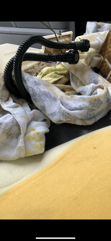

Hey guys! I posted a while back abo it some problems I was having with my 2003 Lincoln LS (V6). The weather has warmed up and now I can get the car to start once priming it a couple times (by turning the key to the third position, firing the fuel pump and turning off.). Once I start the car it idles ok for the most part and sputters a bit when I try and rev it. It won’t go past 2000rpms and if I throw the throttle down all the way she chokes out and dies. I discovered I have a fuel sending unit (jet pump) on my drivers side and it’s leaking through one of the hoses. After months of searching to try and diagnose this car I think this might be my problem? Any suggestions or input? The photos attached aren’t amazing but fuel leak through that hose. Would this be my problem?
