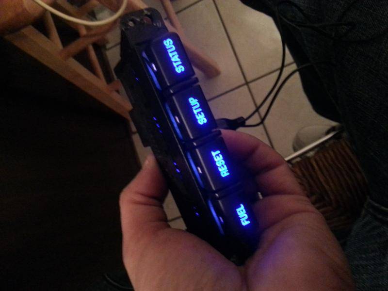

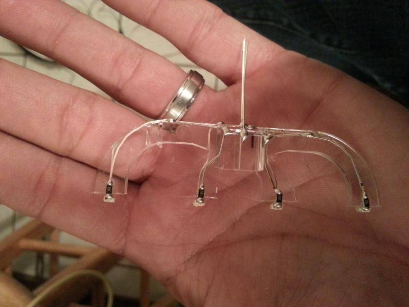

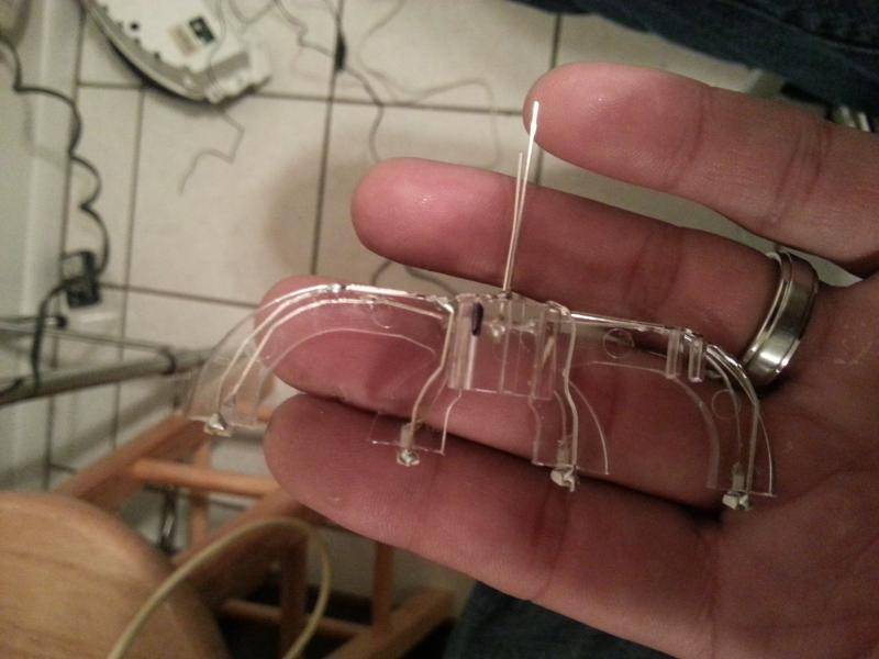

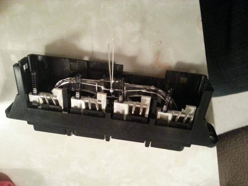

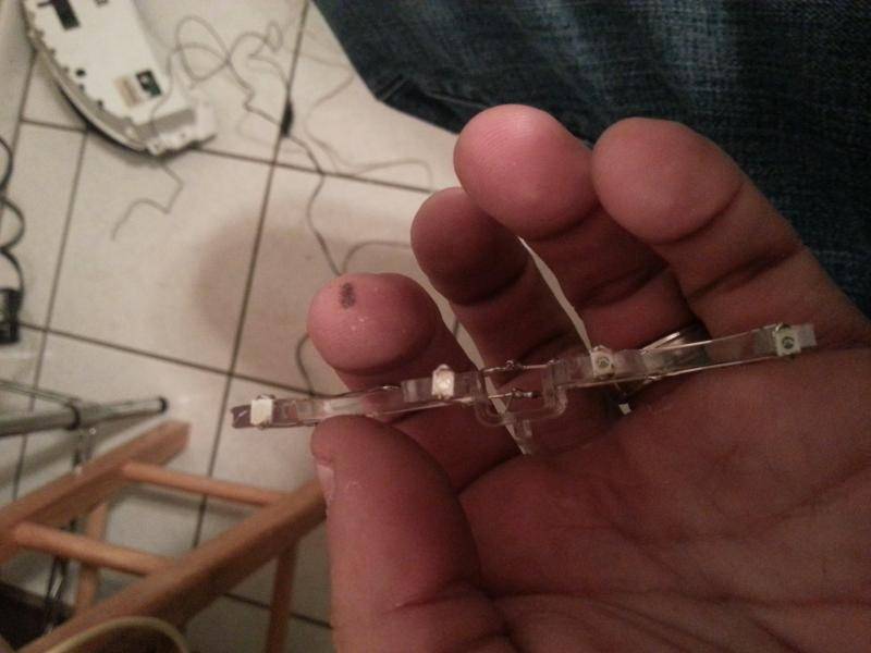

Here's a how to on my 4 button led mod with pictures!
You'll need the following
1: patience
2 : plcc2 smd leds
3 : solder
4 : soldering iron (a good one)
5 : a steady hand
Oh yeah....and you'll also need
Surface mount 560 ohm 1/4 watt resistors
Follow the pics an you should be ready to roll.
