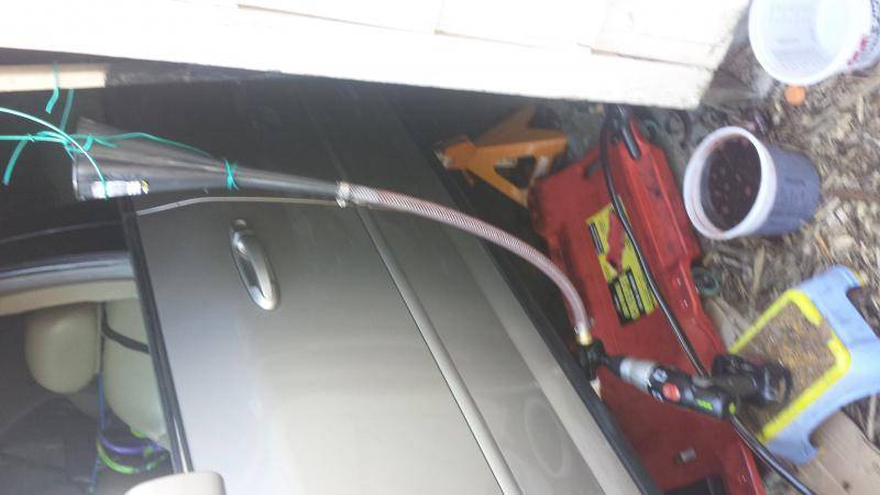

Cool thanks! I changed my fluid yesterday and it went great. I didn't end up using a nipple, just stuck the tube in the fill hole and clamped the tube the cross member so it didn't fall out. I used the method outlined here
http://www.lincolnvscadillac.com/fo...-DIY-Transmission-Full-Fluid-Exchange-(Flush)
Except I used a transfer pump that connects to an electric drill that I got at ace for 13$.
I used a measuring bucket for the outflow and stayed at least a quart ahead putting new fluid in. I did four quarts at a time and sure enough after about 12.5 quarts the new fluid started coming out. I was really happy with how it worked out. I spent more time getting the car jacked up than flushing fluid. See picture below for my setup.
