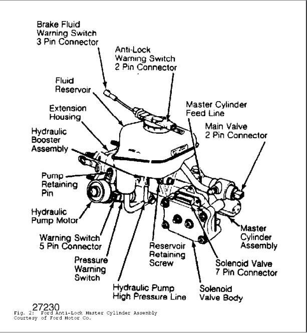

I was wondering if any of you guys know about the ABS in the 1988 Mark VII series. The brake motor pump in my car keeps running until the battery's drained. if any of you can give me suggestions or tips on how to fix it.
I had this same problem for the first time 500 miles from home about 3 months ago.. then it disappeared but returned week before last.
jimmyblue had my answer:
I would recommend first finding the ABS pressure pump relay
and give it a whack
The relay (along with another nearly identical one) on this 88 MVII LSC is in a plastic box on the firewall just above the master cylinder. A whack stopped the pump motor. I disassembled and examined the relay.
Points were fried.. melted in a way that allowed the points to snap-lock together..
Replaced it with a lower milage junkyard part. Parts at Lincoln couldn't find it in their books, nor could the local autoparts store.
