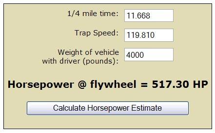

My #'s show 502 crank HP on stock engine. On nos of course. At your own risk. LOL Nawsss man

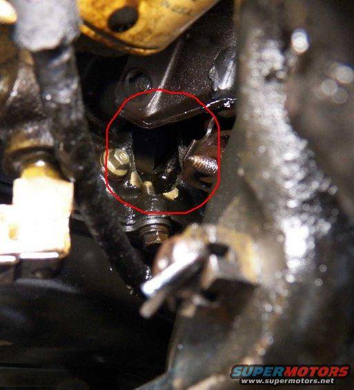

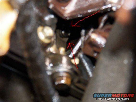

What I did to my 5.4 Lightning Motor a few weeks ago. I put on a 6lb pulley and had a bigger cam but I was too hard on the accelerator. Approx 2 inch hole in drivers side of block. I still managed to make it home and I was over a mile away from home when it happened.
