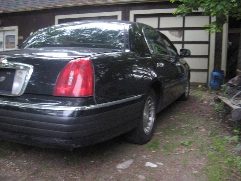

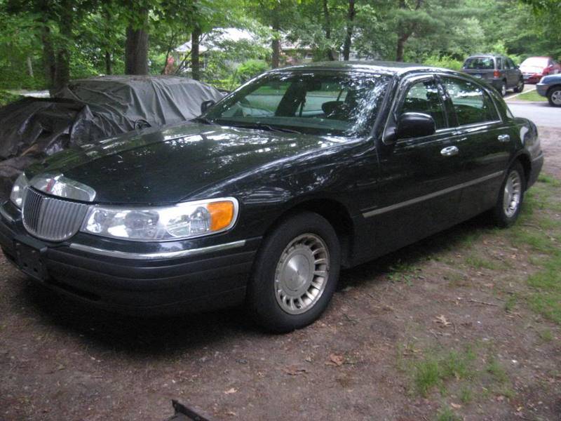

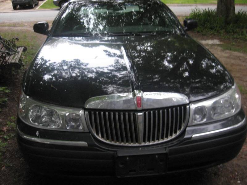

heres some pics...he parked it infront of my garage for now lol...i shouldve taken a pic of my driveway/parking lot...
Doesn't look half bad at all:) I'm sure it was used as a limo as all those TCs with that many miles have been used for lol.
Definately not bad at all for the money.
the guy and his brother are both asian and live in connecticut. they would drive to about a dozen different stores in state monday through friday to prepare sushi and to new york on saturday and sunday with it. they guys wife also lived in maryland and they went down there twice a month, his brother also took it to virginia once or twice a month...it wasnt a limo but it was damn close lol. the first thing i thought was that it was a limo but after meeting the guy he told us all about his trips, we were at his place for 2 1/2 hours.
