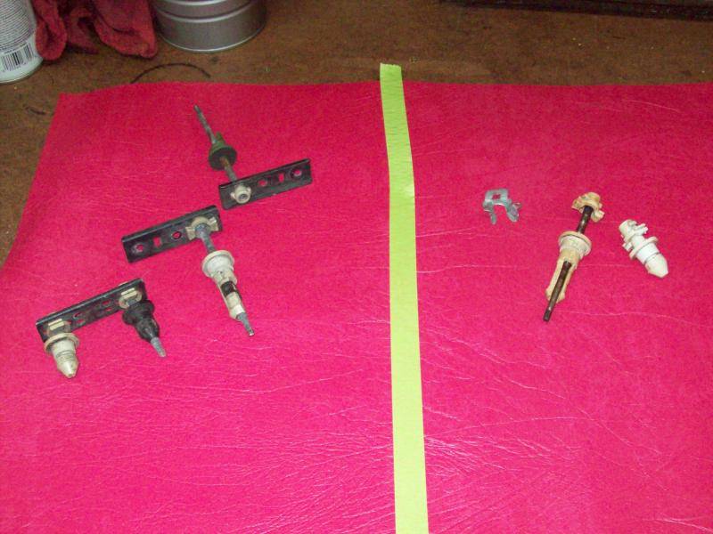

Pic of adjusters, 96 on left, 95 on right. The clip holds the light on. If you have the clips in place, the blue or white rubber nut shouldn't turn when you turn metal adjuster. If you adj the lights while the small white cone looking thing is clipped in, it could break off. If the adjusters are rusted, or the light has been re-done (heated) these will be frozen. Sounds like your missing one of the 3 clips .

I just went out to check, both sides look exactly alike and all 6 clips are in. However, the passengers side adjuster is rusted and not on 0 like the driver's side. I'm wondering if this is whats wrong. So hard to tell, I studied both sides for 10 minutes. I'll just take it off the car tomorrow to see whats wrong.
