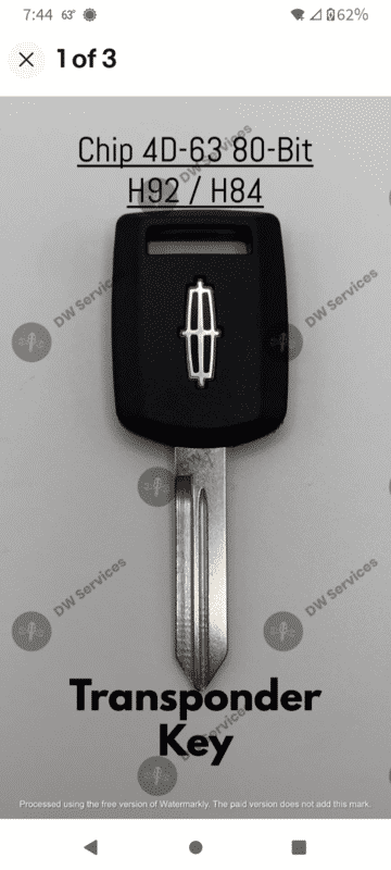

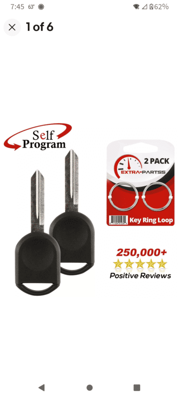

I've included pictures of two different keys I can order one's a genuine Lincoln key the other one is a set of two keys that are supposed to program themselves but that sounds awfully fishy what do you think?

I see that Forscan is gone because it is a Russian company and the US is not so friendly with Russia right now. There are other tools that can do it, but they are probably more than you want to pay for the one time key programming. Just get a locksmith with the right tool to do it for you. He will have the right key blanks too.
All the PATS keys are self programming, if you have two working keys already. If not, you need a tool to put the PCM into secure mode. (Note that the keys do not get programmed. The car gets programmed to accept each new key. Each key has a unique encrypted ID.)
