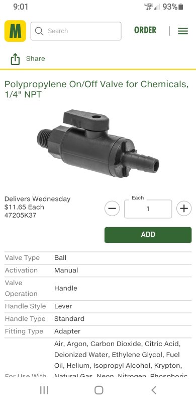

Try this convenient valve with a barbed end female 1/4 NPT thread with a long output tube to keep to pour back in the tank.
instead of the M6 plug. Beats burning fingers.
