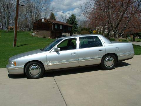

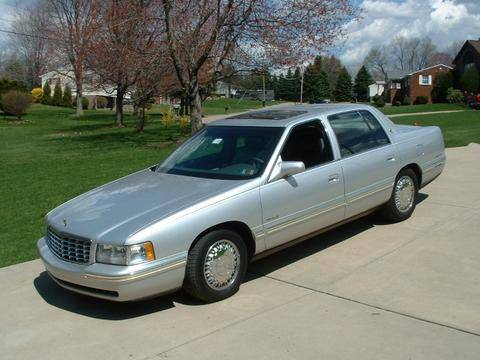

My question has to do with the electronic leveling shocks on my wife's 99 Deville. The car is in excellent shape and only has about 70K miles. We are the second owners and got the car in 2000. The shocks are showing signs of failure (oil leak around the fittings) and I checked to see about replacements. STICKER SHOCK!! Between $1000 and $1200 just for the two rear shocks.
I did find that Strutmaster has replacement coil spring shocks and Arnott Industries has Air Charged Shocks that can be used as replacements.
My question is, has anyone on this thread done the conversion? If you have, what are the pros and cons of doing this conversion.
Both manufacturers say "no problem" and they can get around the warning light on the dash usig some resistors.
The price is about $275 for a pair and I can install them.
