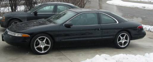

Ride quality diminishes the lower you go, Most of the slammed pics you see the cars aren't driven that way. I'd experiment alittle starting out with about 1 1/2" to 2", then going up or down as you like the look and ride. As far as ball joints my 1st Marks uppers were junk at 65k before I even lowered it, The bottoms were junk at about 75k just after I lowered it. I don't think they're the greatest anyway. I guess adjusting the height on the original joints makes them ride in a different place, and I could see how it would qiuckly finish them off. If they're new I'd bet they'd be fine. The Mark I have now has been lowered for about 18k and 3 years, Haven't replaced anything yet, got 90k now.
