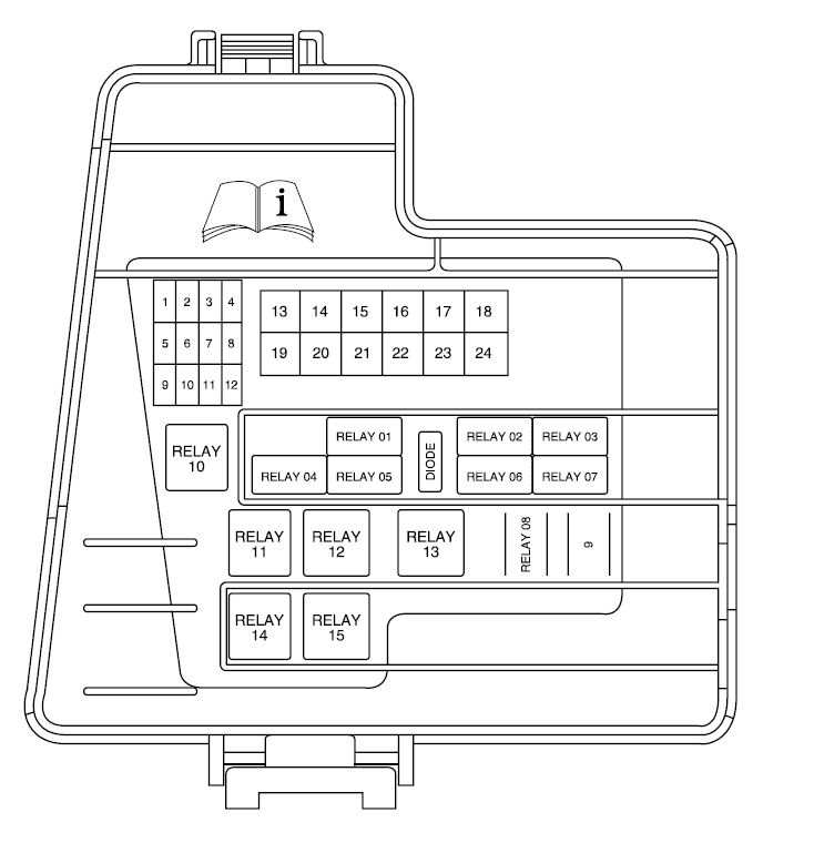

Both are in the hood box. #13 (horn) and #15 (starter).

I checked the relay box. There is no Krown oil inside. I inspected both relays, they appear fine. I swapped them anyway. Car started without a hitch. Tried a second start, starts up. Seems good.
