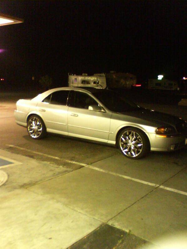

Ok i have a 2000 Lincoln ls it only has 60k miles on it, i just got the struts replaced and new rotors and brakes but now it dies at the lights and stops completely shuts off but the power (electricity) turns on in 1sec but i have to crank it up again its killing me, one mechanic told my it's the tps (throttle positioning sensor) so i had it changed 30min it dies, i know this is a main issue with these cars so Please can anyone help I'm so :confused:

I got same year, V8, and color, but never had the problem, even though I do have a new engine in it now...but never had a problem when stopping.
