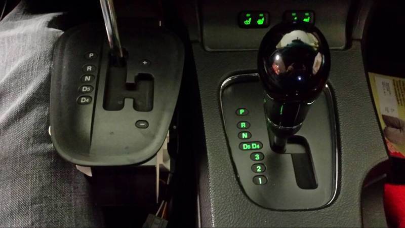

If you replaced the SST shifter for the base shifter I believe you can't access 1, 2 or D4 without a non-sport calibration. There is a thread here somewhere on this... The computer reads the shifter vertically so it reads P, N, R, D5, D4 in SST and P, N, R, D5, 3, 2, 1 on the base shifter. To access D4 the computer needs to know that the shifter slides right to access D4.
Thanks Jeff :) We are getting slightly different results but that could be driver error on my part since I really dislike the +/- sequential shifting and seldom use it. When I tried the double tap to go down two gears a few times it only went to the next lower until I did a third tap. When I come to a stop in either 4 or 5 the trans shifts to 1 (per the owner's manual and my experience). If I don't want to upshift to 5th, D4 will hold 4th gear for me. I can't imagine why I would want to avoid downshifting from 5 or 4 anyway.
At the moment I have D5 and D4 operating as they should. When I move the lever to the right on the jog I get D4 and the dash displays D4 rather than SST.
I have the instructions for resetting the trans to DST thanks to an older thread on this forum. Basically I just deny the VIN that shows on the WDS and then reenter the same VIN and go through the calibrations for the 50 state non select shift.
Weird.... But then again you may be the first to go from an SST shifter to a base shifter. You can probably get good money for the SST shifter.
Those are the correct instructions (you're looking for a non-sport calibration). It's just tough finding a dealer that will do that...

Well, I visited my local Ford dealer yesterday for re-configuring the PCM so it would recognize the input from my change to a non-sport shifter, aka DST.
Apparently the proprietary diagnostic tool (WDS) has also been reconfigured such that it will no longer allow the VIN reentry method but instead asks for the number on the "tear tag" on the PCM itself.
The tech is calling Ford technical support today to see if they can access the correct number otherwise I will be briefly removing my PCM to get that number.
Any input from members who have encountered this bottleneck would be greatly appreciated :).
