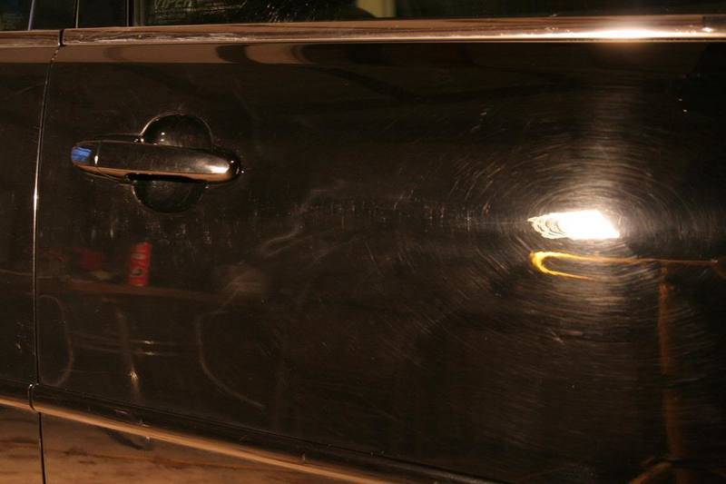

Took delivery of this one on Monday. Guy is going on vacation for a week, so I have until Tuesday to get it finished. As you will see, I will need all that time to complete it. At least 2 steps (damn hard clear coat).

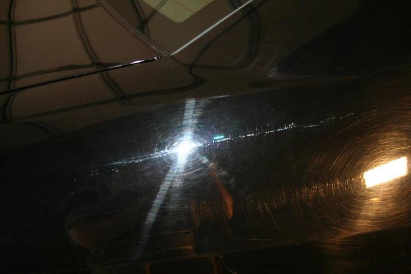

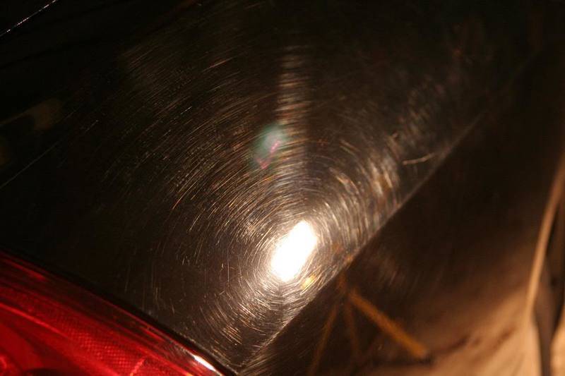

I knew I had my work cut out for me when I could see this through all the grime still on the car (I instructed the owner not to wash it beforehand):

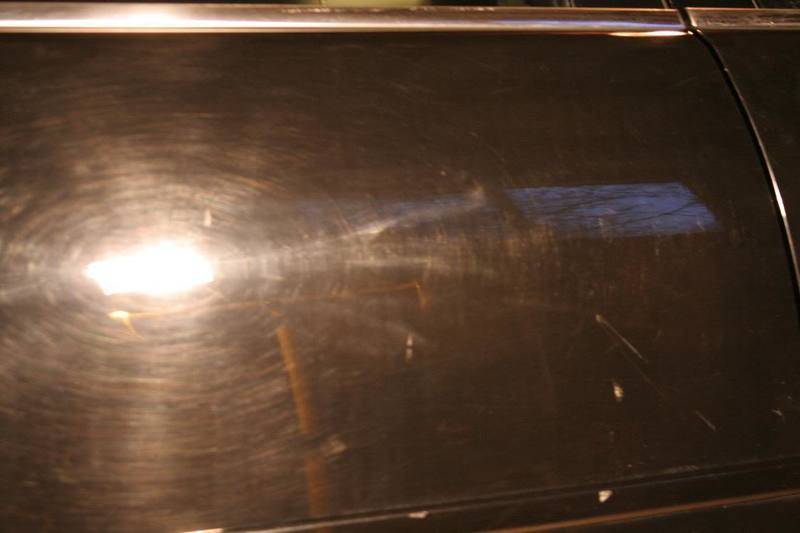

After wash/clay. Those with weak stomachs may want to skip this part:
Nice buffing job before, eh?

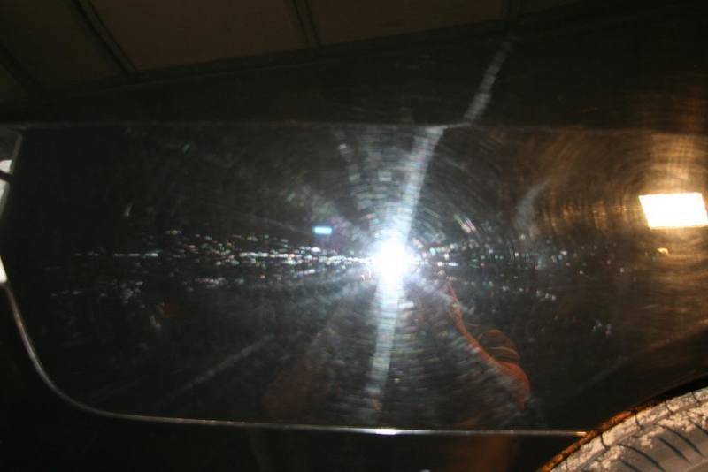

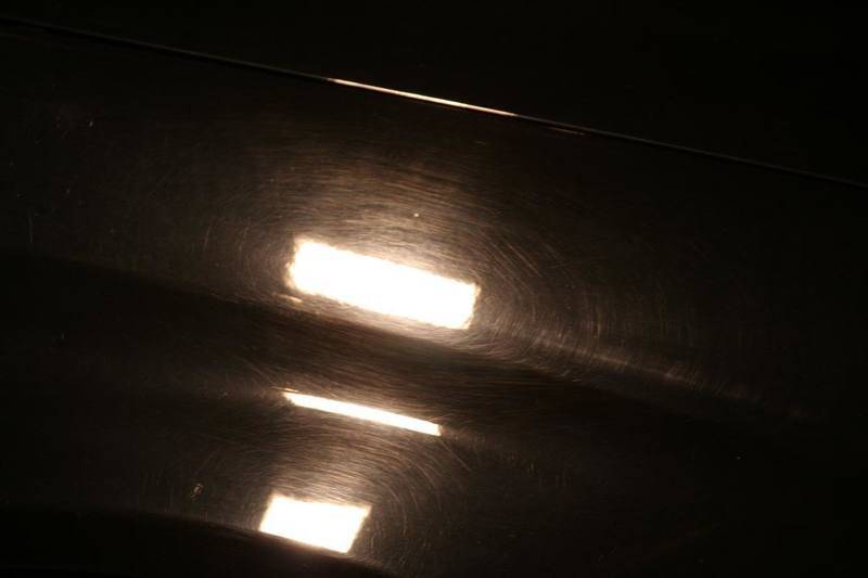

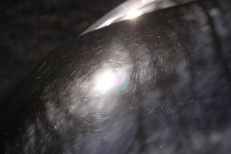

I tried Power Finish with Uber green with almost nothing taken out. Stepped up to SIP/yellow. Still left a lot of defects. Then I tried SIP on 3M white wool.
Test spot:
After one hit:
After 2 passes:
Never mind the terrible holograms. I don't worry about finishing down when compounding. I try to just get in and get out, and worry about cleaning it up with the next pass, which will be power finish on lc white.
After this, I became engrossed in correcting the paint. I did not stop to take pictures. I felt time was working against me, so I just did what needed to be done.
After the wool step, I use a combo of SIP and 85rd on uber green pad to finish.

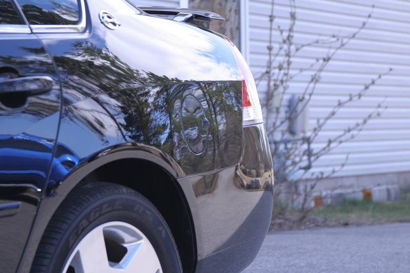

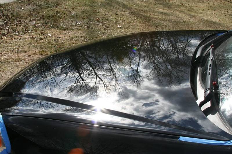

Here are some pictures when I pulled the car out to check my work:
Then I pulled the car back in, corrected a few holograms, and started on the LSP.
1 coat of EZ creme glaze
1 coat of Blackfire Sealant
1 coat of Supernatural:

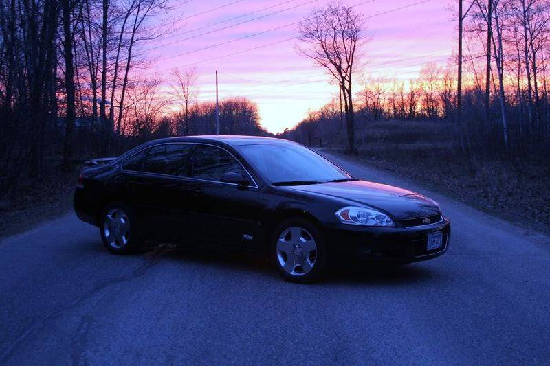

These pics I got the same night. just before my camera battery died. Super pissed about that , because it was a nice sunset:

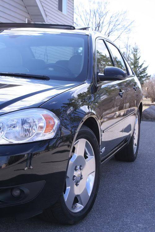

Then the camera battery died, Owner came by my work today to give me the payment, and so I could take a few more pics. Enjoy :D
Wetsanding would've taken care of the orange peel, but that wasn't in the cards this time.
here you can see the owner smiling:
