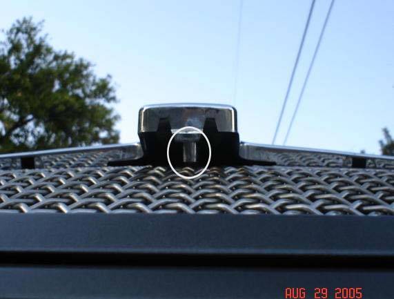

hello guys its me again well this front grill has been bugging the $hit out of me its kind of sticking out and i frankly dont know how to make it fit flush... any suggestions? ken i think you might know...

There are three pieces to the CDC grille. One is the mesh grille, the lower bezel and the other is the piece that pushes the mesh grille out flush with the upper grille. You are missing the third piece from your kit. Also, you need to take that piece off that is behind the emblem. It's a round piece that can be taken off with a pair of snips.
Here's a picture of the item you are missing. I have two of them shown but you only need one. It goes behind the grille mesh grille and you put a screw through the mesh to hold it in place.

You may need to shim it more with something else because it isn't pushing the top of the grille out. Also, you need to remove that round piece behind the emblem.
In the picture below is the piece you need take off of the back of the top grille bezel. I have circled it. This is keeping it from sitting flush.
