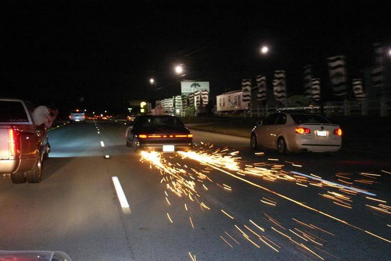

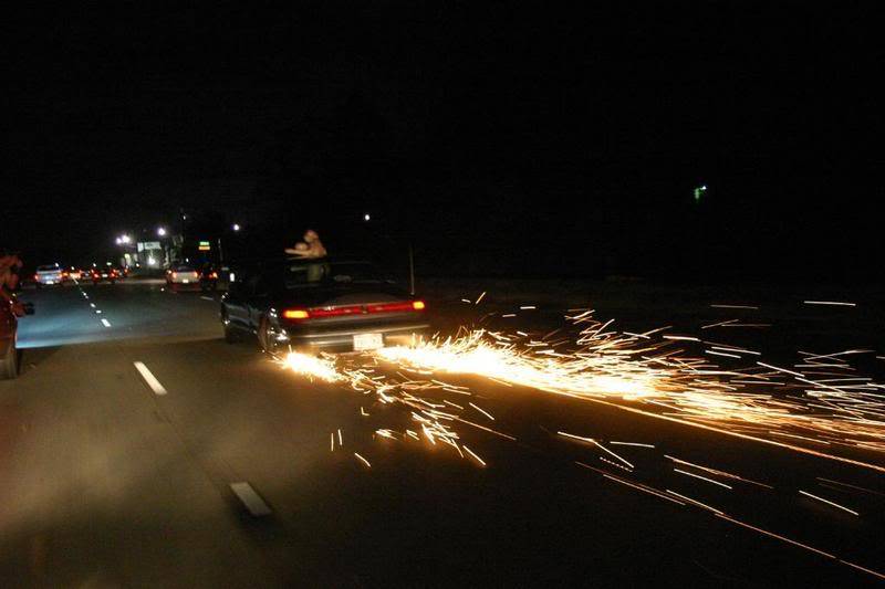

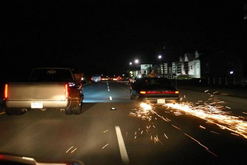

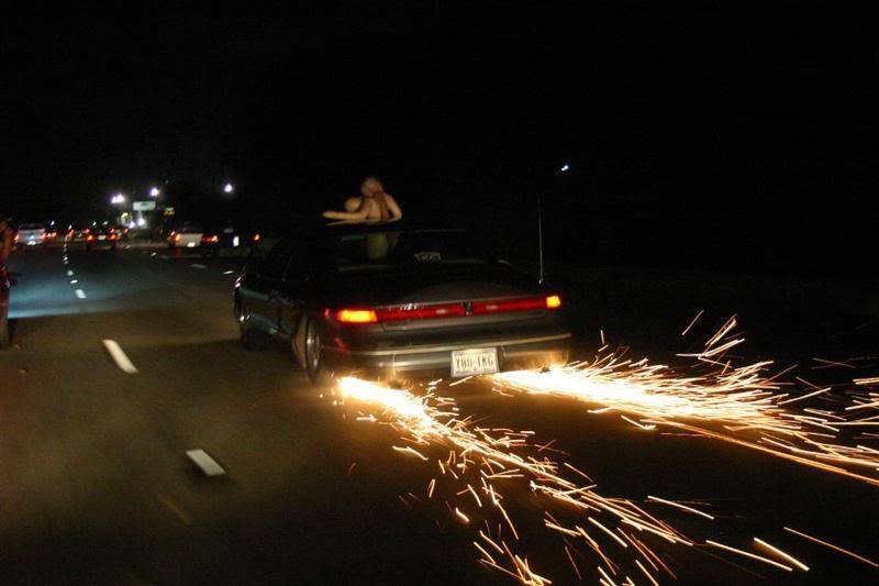

Here are some more pictures of the markViii and a video.
Is slowly coming along.
that is the dumbest thing i have ever seen
i want my 2 minutes back
whats the point of that......besides probably making a ton of noise and destroying public property
in that one picture of them hanging out the roof, is it just me or does it look like one girl is sucking the other girl's...breasts?

Nothing wrong with jugs, but the pavement is our tax dollars
If you like I can post pics of the pavement afterwards. nothing is damaged, so what, If I chose to grind down some trailer balls.
Would a more suitable video for your 2 minutes be a crackhead getting a fix?
I know Im certainly not the only person who would perfer to put their mark on fastbags.
I have done a very difficult conversion, the front was a pain in the ass to say the least but its done.
To those who do care.
Im using Slam Specialties RE-6's all the way around,
ODE 1/2 Electric valves.
2 6 gallon tanks
and An Oasis
oh and the thing hanging out of the roof is a blowup doll. The pics were taken at Turkey Drag 07
To Mr VR4, I have a go fast car too. I dont really see the point in going in a straight line ;) Its my hobby and figured Id share.

I knew that was a blow up doll and i know those do not do much damage to the pavement,enjoy your hard work and your ride and always check for a gas leak:)

Haha, so I was kind of right even if they are fake boobs on a blow up doll. Plenty of real women have fake boobs too!
I'm not being a smart ass but I would actually like to see the pavement.
And do you just put a trailer ball on each side of the car because from what I see there are sparks coming out of the sides, not the center where a trailer ball usually goes?
yes I have put the hitches on the rear most body mounts, Id rather drag the trailer balls off, then the stock body mounts.
next drag session I will be more then happy to post up the marks that are left. its no different then somone doing a burn out.

I would like to see what the balls look like after that? How do you have them attached to the car? Any pics, how long do they last?
I have re-enforced the rear body mounts that hold the diff/suspension craddle
and I screw in 2 7/8" trailer balls, that particular night a set of two lasted about 20 miles, there is barley any weight on them when they contact the pavement thats how you keep from tearing up the road and throwing debris to cars behind you.
