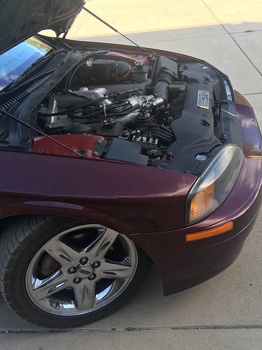

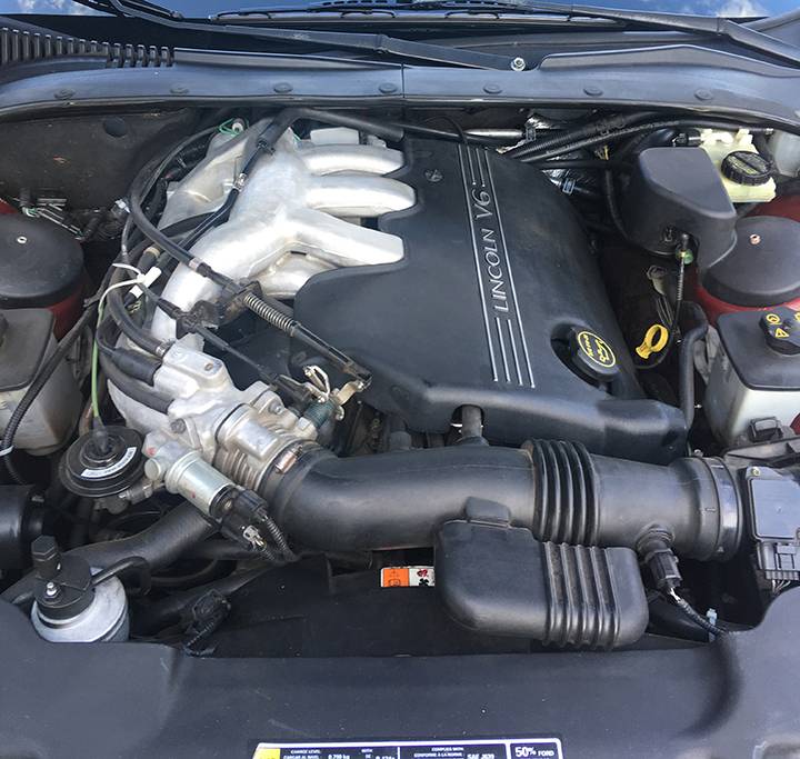

Hey shifters just a couple pictures showing my 5 speed. Still driving her. :)
