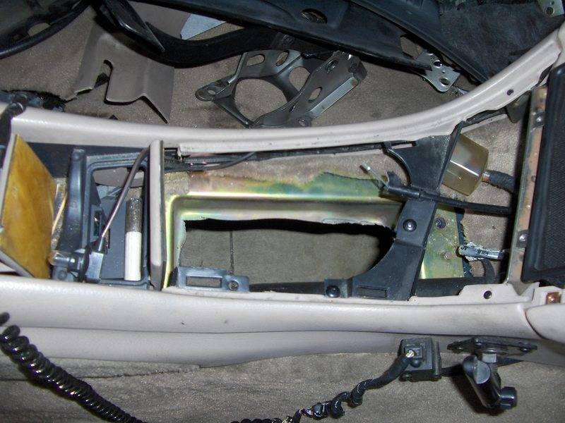

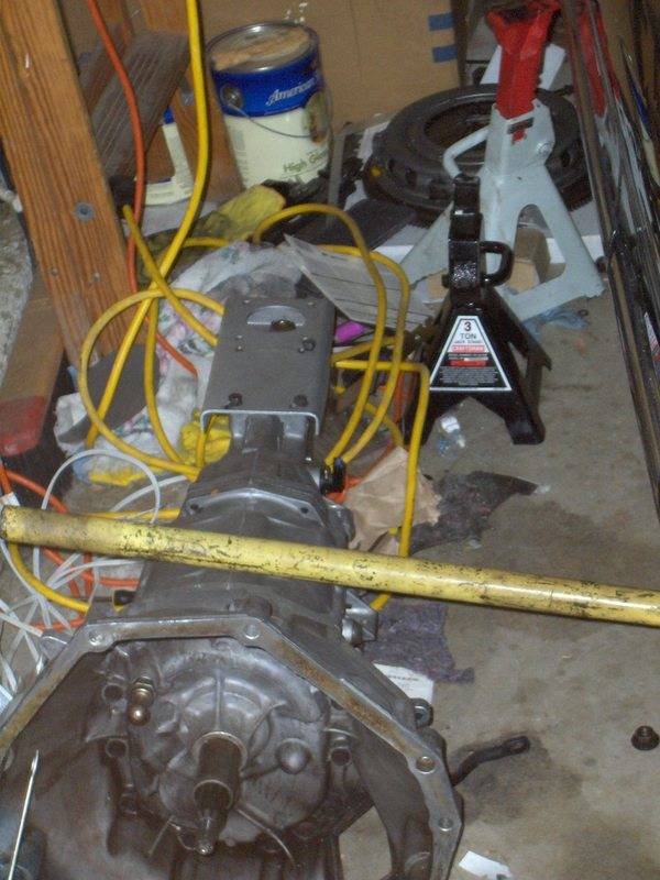

Don't attempt this unless you have half a brain, a big wallet, and a lot of patience. When it was all said and done I don't think it was worth it. Check out some of my pics.
