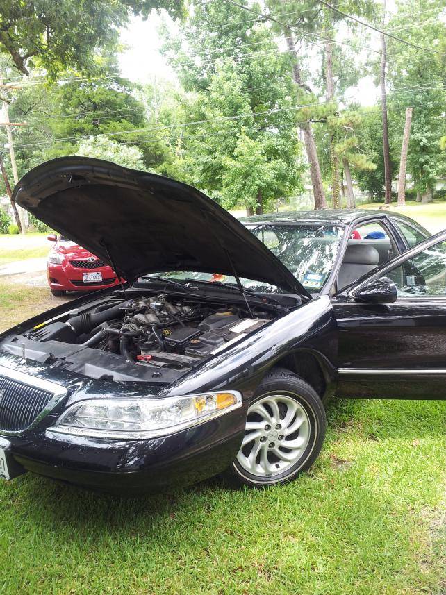

heres a pic
OK your trying that the main thing. A big TIP for you put your rims on correct! The swirls all swirl BACK on top of rims. If you want to test which cat is bad take out the O2 sensor on one side and drive car. If it hauls butt it was that side cat. If its still slow its the other side. So put first 02 back in and take out other one and run car to make sure its the cat. The hole that mounts the 02 sensor is big enough to let engine breath and rev. You stick with us and you'll help you out. Oh BTW the muffler guy should have known this.

ok my bad i had to read it again lol i bought the car with the wheels on just like that lol bt appreciate the ill try it....
You think I told you to reread my post because of the rims? LOL NO. I explained how to check for bad cat by removing 02 sensor(s). BTW are you a M or F?
He was talking about the O2 sensor part for you to read again. The wheels are not what is causing your problem. It doesn't matter if you changed your O2 sensors, one of your catalytic converters is clogged. So to figure out which one is clogged, you are going to have take the upstream O2 senors off from one side and see if it makes a difference. If your problem is solved by removing that O2 sensor, then that is the side that needs to be replaced. If it doesn't resolve the problem, it is the other side. (just paraphrased what "Right on the mark" said but hope it helps)

Zoe, 10 spoke rim direction has little to possibly no effect on exhaust
