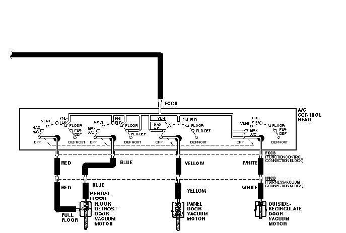

Can someone please help me I have a problem with my cars HVAC it always stays on defrost,you push panel,and the setting stays on defrost it worked great till one day it just stoped.Thanks
Chaoticbastard said:Ive seen them end on ebay at 26 Bucks.You gotta know how to look![]()
67Continental said:Before you replace it, check the vacuum as was suggested above. I had exactly the same problem, and I had a vacuum leak in the tube that goes over the intake manifold in the engine bay - definitely check that.
