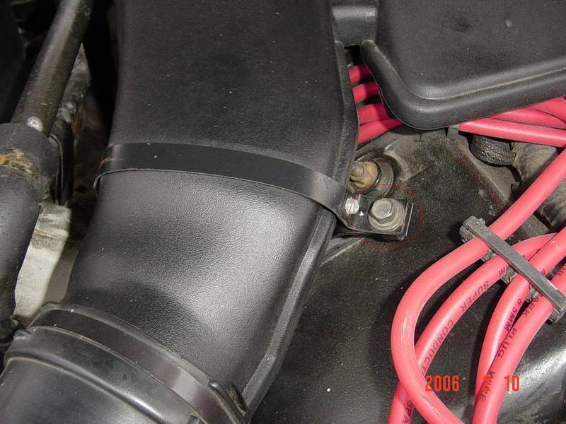

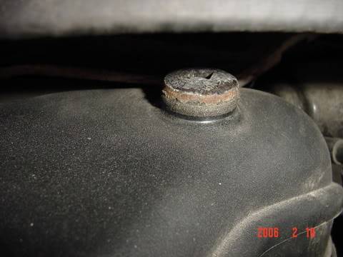

Motorcraft wires are over 100 dollars for this engine. Might as well go with MSD. Here are some pictures to better explain the taking off of your TB tube...
You have to obviously disconnect your TB tube elbow from the airbox, Then you'll see a 10mm bolt IIRC. Then, Toward the firewall, i believe you'll need a 1/4 drive ratchet (no need for sockets), you must loosen that and also take the cowl panel above that off so the back of the TB tube will clear it and allow room for it to be pulled out.
