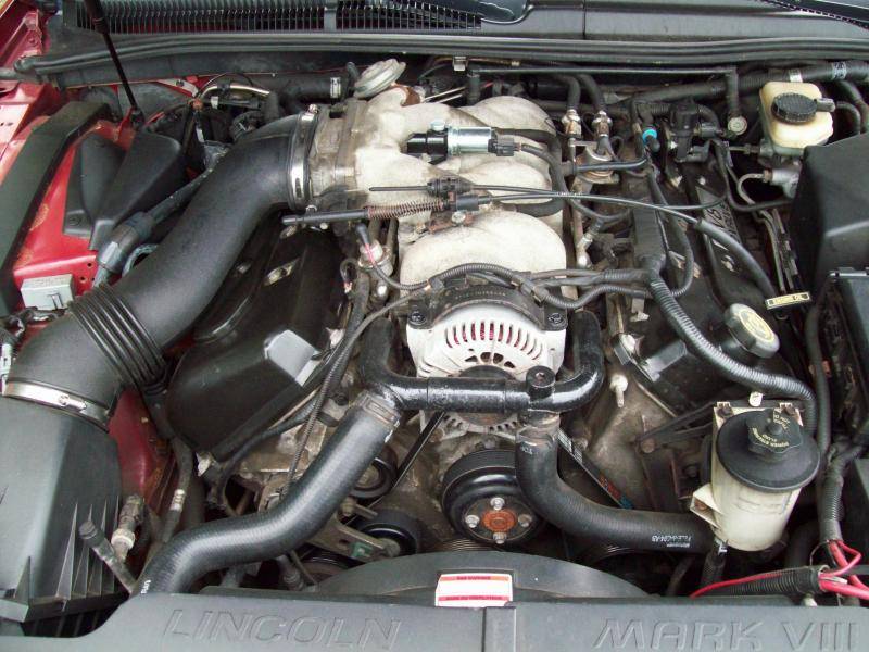

97 FS 7.jpgIt's that shiney thing right on top, and don't forget a new gasket
