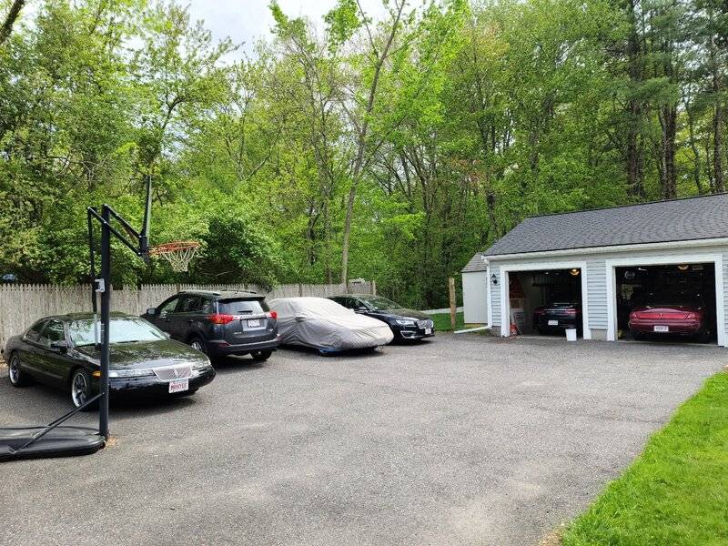

It saddens me to realize that for the past several years I have been neglecting the Marks. I would throw half ass attention to them when I would have both the free time and motivation, which is a rare combo. I’ve got a list of maintenance to do so thinking I am going to shop this out soon and get back to enjoying them when possible. First up will be an Exhaust for Hyde, and then brakes for the Vert. Then hopefully a stereo upgrade for Hyde, and a new Top Motor and Hydraulics for the vert. Then new carpet for the vert. then….. the list goes on……. And on…….
Neglect is the enemy. And I have been out of touch with the Mark VIII lifestyle.
Neglected my 98 Base for years. When these things sit it gets expensive. Just had to replace tires, brakes, hoses, plug and boots. And a few other items after letting my Mark sit 3 years. But found the love again. Turned the base into a daily and purchased a low mile LSC Florida car to take the garage spot. Won’t let this one go without attention. Gonna enjoy them both and keep them alive for my kids down the line
