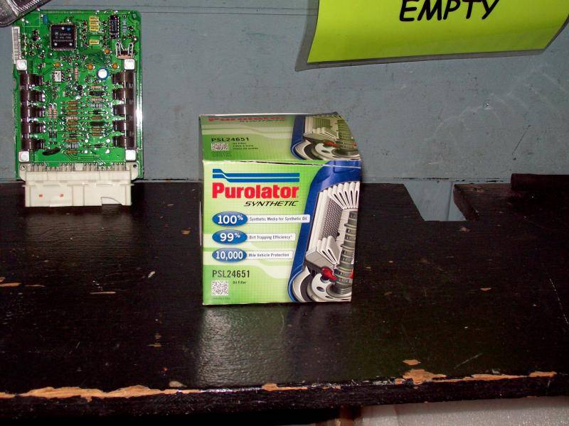

oil filter.jpgI picked up these syn filters. Time will tell. Changing the filter on a gen 1 is a pita compared to a gen 2. Been doing my gen 1 every 3000 miles for 14 years.
