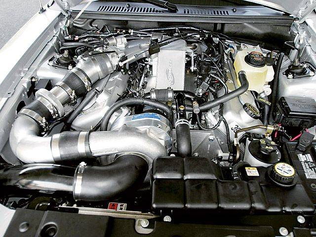

How is the clearance for the vortech? I’m about to do this, but I read someone had to move the radiator down and forward to clear the inlet. Did you have to do this? Anything else?
