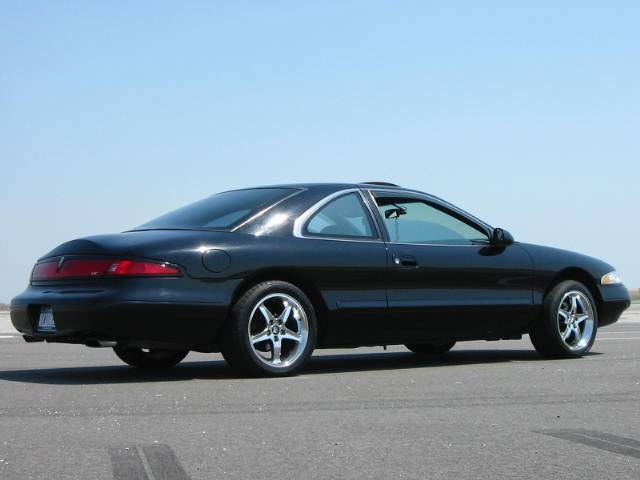

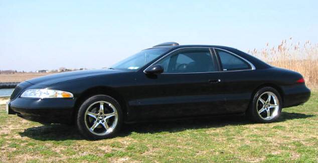

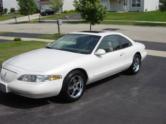

Basically theres the CobraR made for the Cobras several years and even the SVT Contour had a very similar looking wheel a few years. There made in all kinds of sizes and fitments, I've seen 16s-20s. There is slight variations in the exact style from manufacturer to manufacturer. The Y2KCobraR wheel is the less seen one as it was to the best of my knowledge only put on the 2000 CobraR as original equipment. Thats what I have.

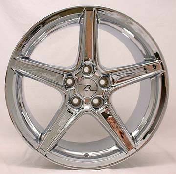

They all look excellent! I like them in chrome especially! Who sells cobra r's on ebay? What size and offsets do I need? What you guys think of these??? What are they called and where can I get em??

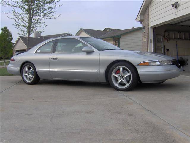

Will this size work on my car??
The wheels are 18x9 with a 5.95" backspace (+24mm offset). The lug pattern is 5x4.5 (114.3mm
Nope thats a mustang lug pattern-The Mark is 5x4.25" bolt pattern same as 5 x 108mm.

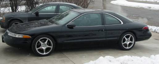

I think these will look nice on mark 8
