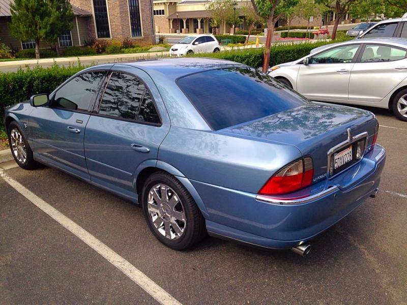

And here's a pic just for fun - just had the tint redone all the way around.
