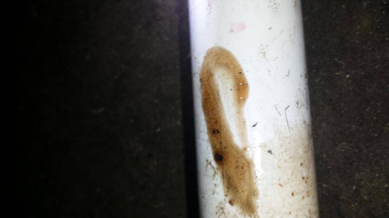

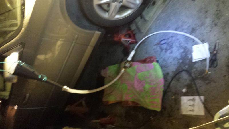

I jacked the car up and leveled it and checked the transmission fluid per the procedure I found posted on this forum. With the car warmed up and running I took out the fluid level plug on the bottom of the trans. Some fluid dripped out so it wasn't super low. I did notice the fluid was mostly black so I think the fluid needs to flushed and replaced completely. I refilled it with this contraption I made. My question for you is if you think old fluid could cause the stalling problem as well as low fluid.
I've included some pictures. The first is the old transmission fluid smeared on a white surface so one can get an idea of the color. To me that fluid looks bad and needs to be replaced, but I would welcome any other opinions or confirmations. The second is the thing I made to pump fluid into the transmission. It is overkill but I wanted to make life as easy as possible for myself while I was under a running vehicle. If you are thinking that this contraption will just end up falling apart and spilling fluid everywhere you would be correct. I did eventually get it to work though. I ended up just sticking the end of the tube into the tranny fill hole instead of using the brass fitting on the end. If anyone is interested in the details of how I made this I would be happy to share. I have searched through a few pages of a search I ran on flushing out the transmission but haven't found a thread with clear instructions on how to do it. Several people said to have the dealer do it but they want $329 and I would prefer not to have to pay that. If someone can help me out with instructions on how to properly flush the transmission and replace the filter I would very much appreciate it. Thanks.
