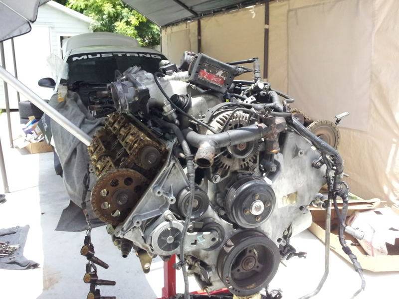

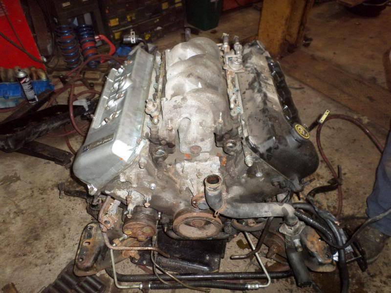

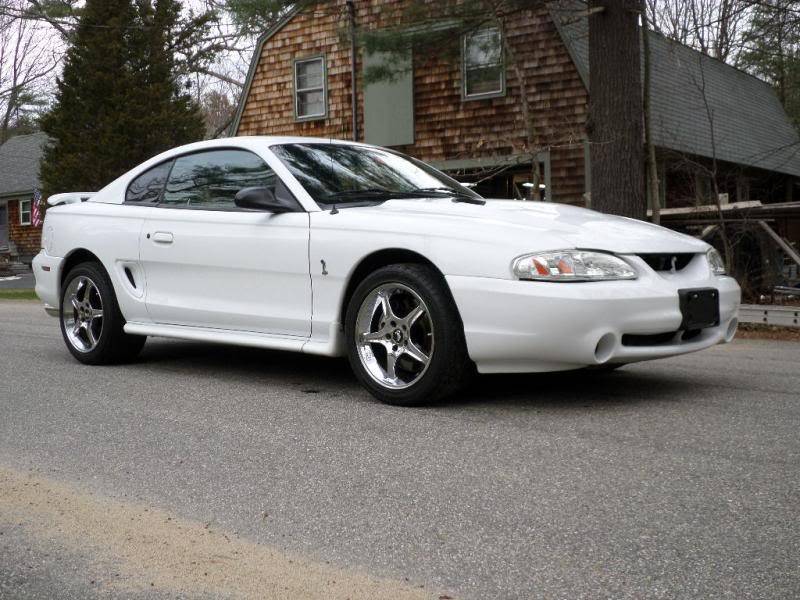

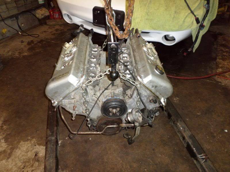

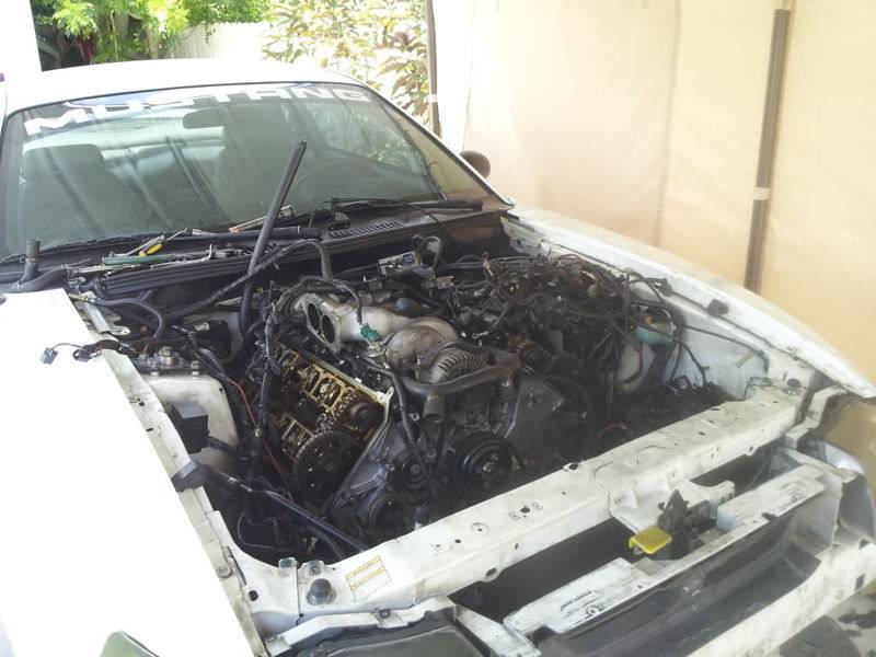

My buddy has been a long time 5.0 fan but he noticed how well my mk8's run at the track and wanted to give a mod motor a shot. He picked up a 98 Cobra with an engine problem. I pulled engine down and decided we needed a new bullet. (cheap) Called up Bruce from this site and scored a cream puff 1997 mk8 engine with 91K. I turned my back and here is engine trying to turn into a cobra engine.

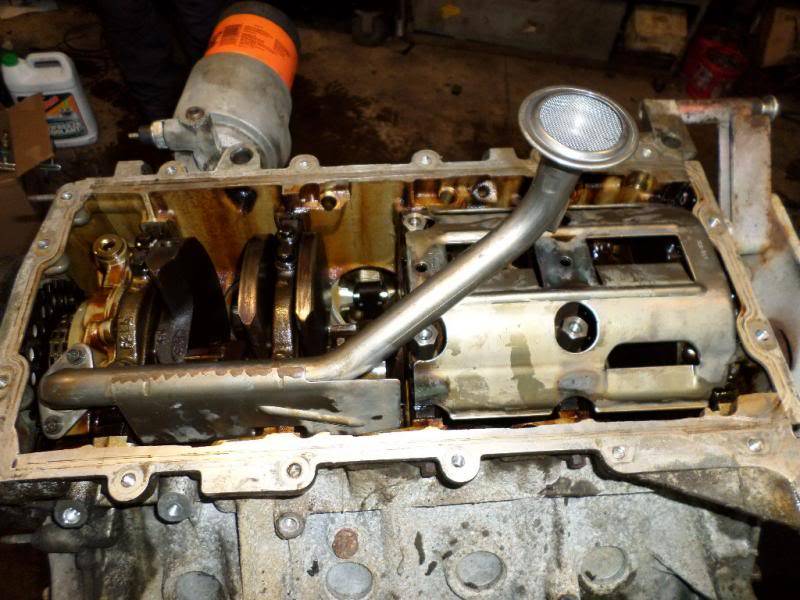

Swapped on the cobra oil pickup ,3 main studs,windage tray, oil pan and oil cooler.
Put in new plugs,new poly engine mounts and a Billet SFI 6 bolt flywheel and Spec stage 2 11 inch disc and PP that I got off the 3V I built my buddy that I switched him to a twin disc. All cleaned up and ready to drop in.

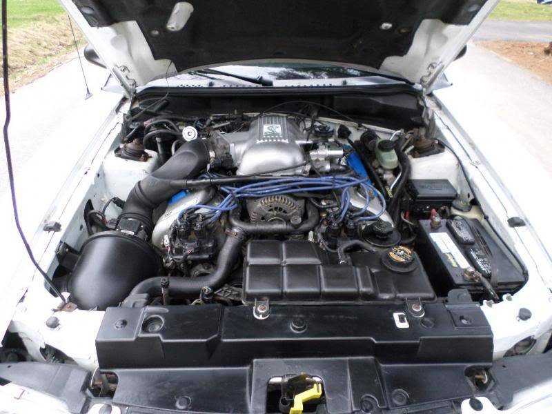

All done and runs like a top. And yes I didn't swap in the cobra intake cams because I did all this for no cash for a friend.
Mark 8 power for the win.

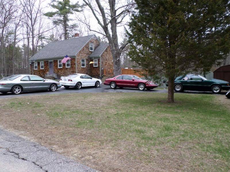

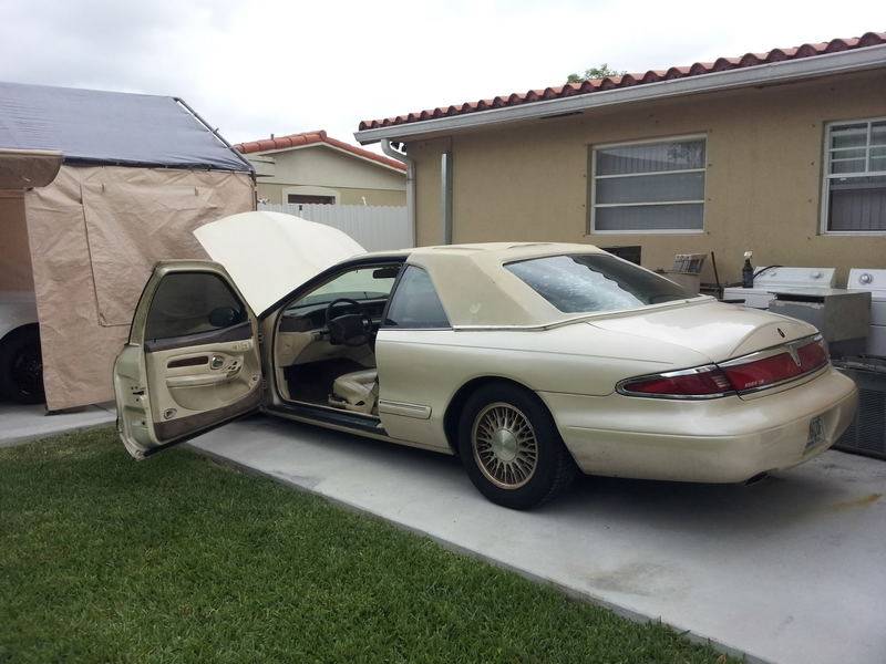

Pic from today with my cars and his cobra.

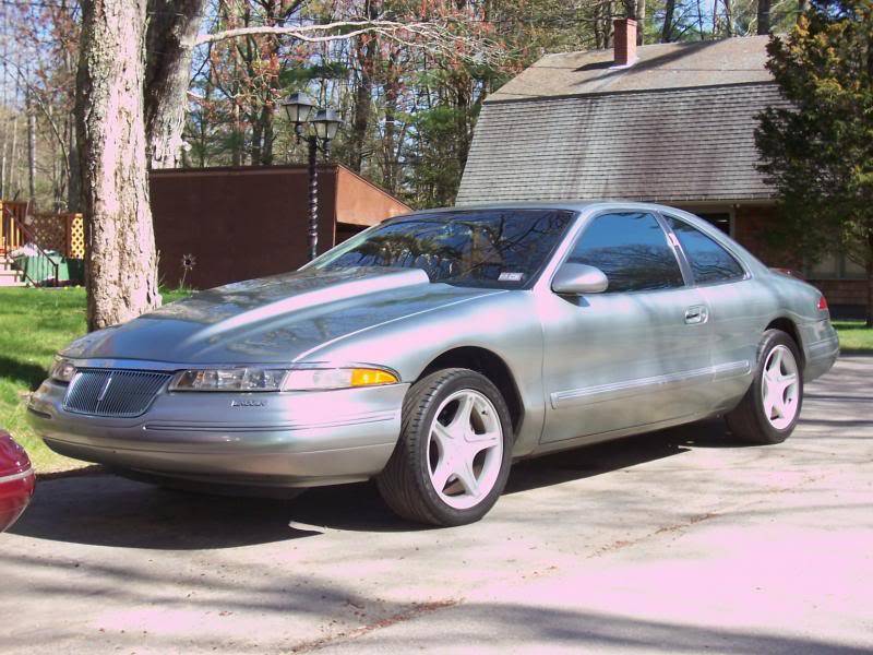

I like that grayish mark, does that have 99 mustang gt rims on it? Or is it silver?
Grayish pffftt! That is my world famous (lol) Standox "Imola Ice" car. Here she is when I first picked her up after a 10 year nap in a garage.
The car turns steel silver to willow green to a purple hue in different light. I was bummed those 18 inch Pirelli P Zero Rosso tires are flat spotted so that why I switched to the 2000 GT rims. This was before i lowered her.
