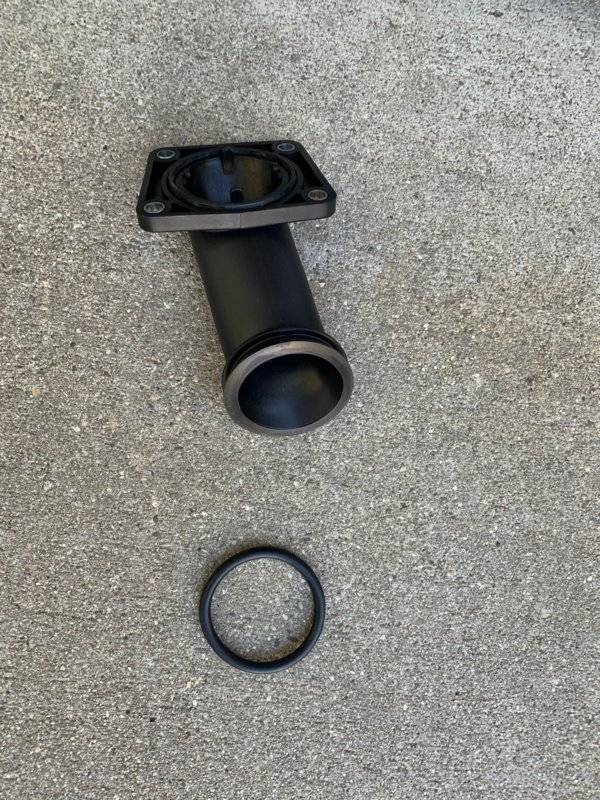

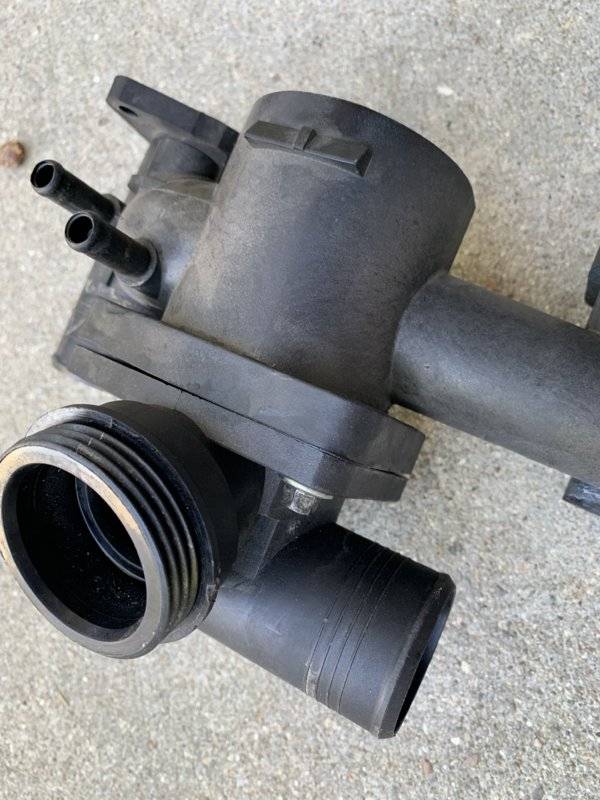

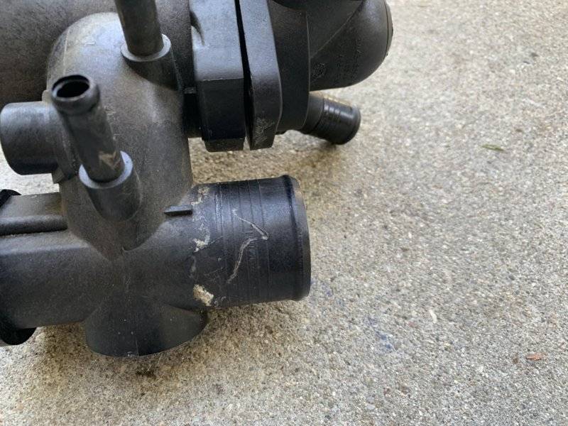

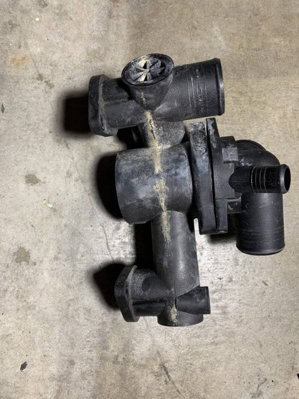

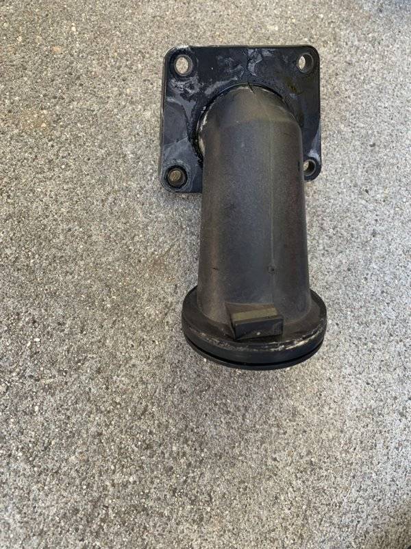

I actually did the coolant trick installing the crossover pipe into the 9N499. Pics below of the pieces I took off. The O ring around the 9N499 looks really smashed. You can see the stuck bolt and where the coolant had sprayed. I honestly don’t think there are cracks or anything in the pieces themselves, the leaks are coming from the mating points and not being able to torque the bolts properly and/or the gaskets not sealing properly. Regardless, all new parts installed.
And, the ancillary issues...the hardest part is having to take the intake manifold off. I had, unnecessarily, unplugged the sensors under the IM. Then, putting the IM back on, I had one of them, the crankcase temp sensor I believe, routed wrong so They don’t lay right behind the fuel injectors. Just dumb stuff like that!!!
