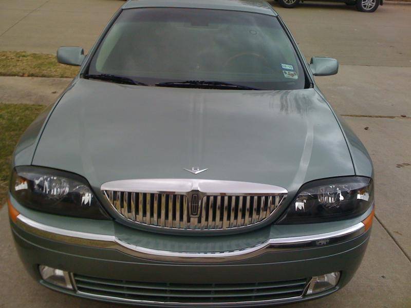

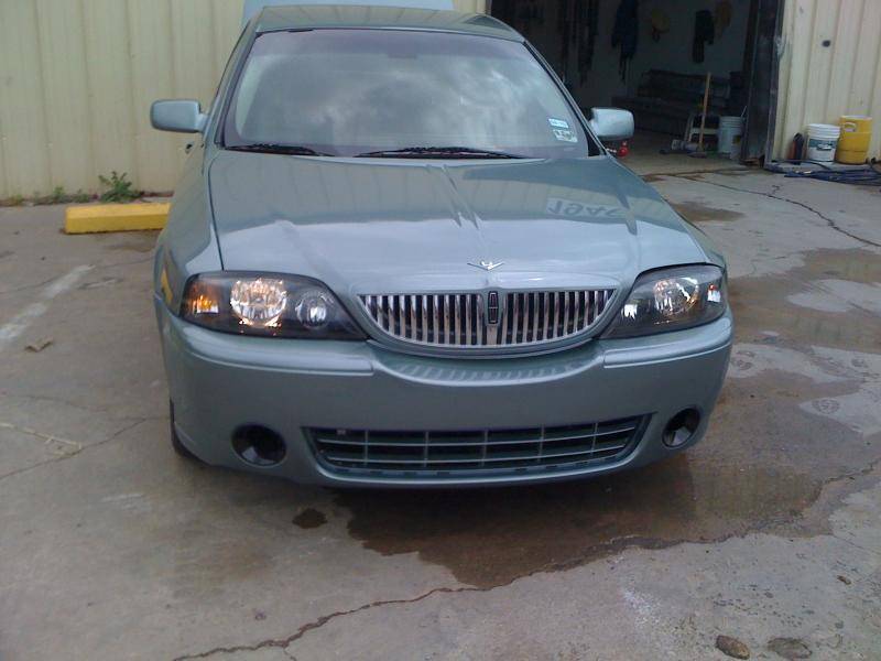

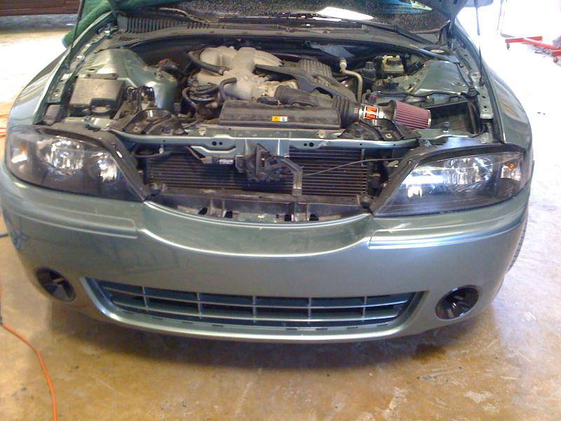

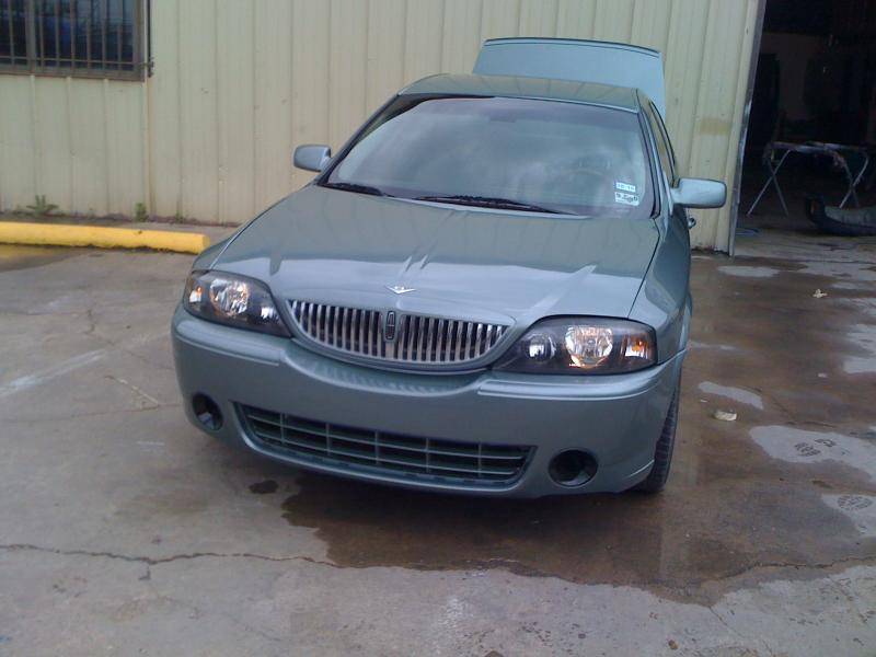

if you look at the driver headlight there is huge gap between hood and headlight. i dont know what or how dat happen but they told me is because my transmission got hit so it might be pushing it??also the last pics are what my 03 lincoln ls looked like when i first got it before the wreck. :confused:
I wrecked the front of mine and mine is slightly up on that same side like yours. But mine doesn't seem as bad. Plus mine is black.
Try adjusting the hood latch to pull down more, you have to get it to when it latches, it is kind of tweaking the hood to sit flatter.

Looks like it wasn't aligned correctly when it was repaired.
its dat what you think the problem is because i will take it back and make them perfect the job i paid $1050 for

There are stop adjusters on each side of the body/fender that (dat) screw up or down to adjust the hood fit, try dat(that).

Or, just adjust the stopper on the drivers side to make sure it isn't holding the hood up.
