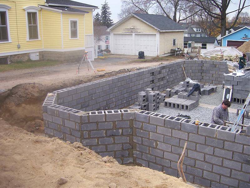

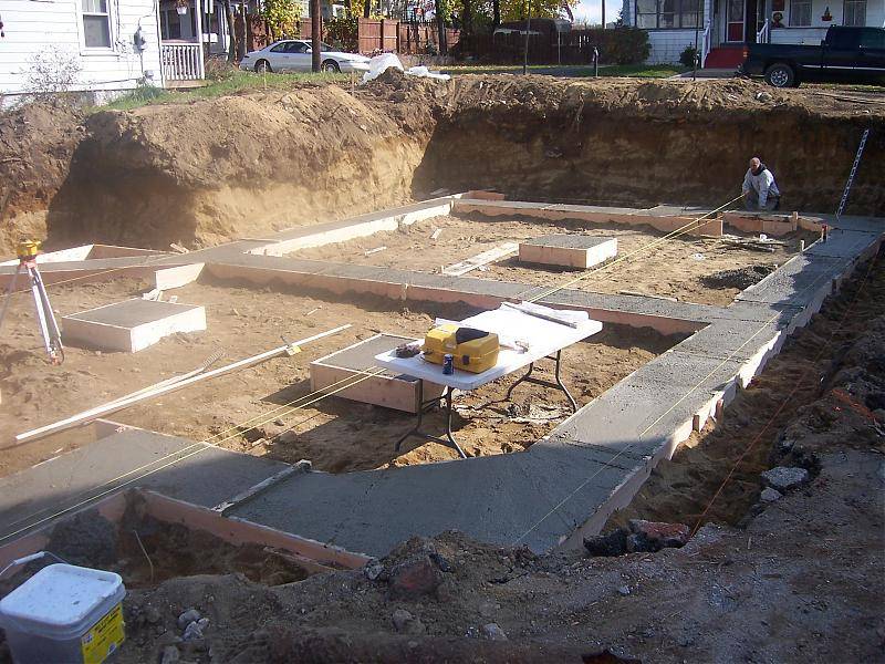

The footing, stone and foundation walls are in. I'm starting to get HAPPY! (ALMOST!)
I like the way they did the footings, they look real good. Um with me being a union bricklayer for seven years do you want me to start picking out the shortcomings in their block work now? Cause I already have a small list going. I'm very disappointed in the block work.

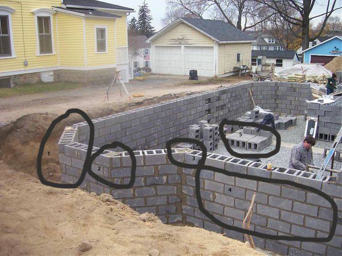

1st pic
1. This wall is all jam block, not structurly sound, Wire on the wall. If this wire is under grade it will crack the joints. I'm gonna take a stab and say they didn't fill the block solid below grade either. This will cause leaks and cracks on the foundation.
2. This must be the new guy. The joints are smeared, #1 sign you don't know wht the :q:q:q:q your doing. Mortar works by compression, it's not a glue. Also their all jam block (square edge).
3.WTF is this? a 4 inch cut in the wall? Never a smaller peice then a halk block on something like this. Plus its smeared and not keyed ( keyed is filing the ends in with mortar to lock it in place.
4. All jam block again, plus these are splitable block, very not good. Splitable have that little gap in the middle web, Hit them with a hammer, and bam instant half block.

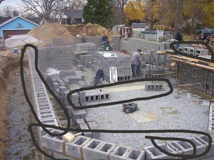

Pic 2, oh my god.
1,2, and 3 are cold joints. Thier is nothing bonding these walls together. They should have run the block across the 45 to fix this. These will have cracks in the corners by next year.
4. LMFAO, looks at the head joint holes. Half of these are empty. You have no mortar between these. And the bad thing is empty joints on the outside allows the walls to be pushed in.
5. is just all those jam block again.
All in all their not going the extra mile to build a quality product let alone a decent one. If my guys every got caught building stuff like that I would knock it down with the skytrac and have them redo it, Those walls will not pass inspection if a inspector showed up and seen them.
