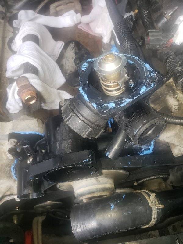

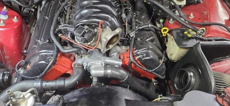

I am aware of the aluminum thermostat housing for the Gen I (I have installed one myself). I'm curious if there are other plastic components that can be replaced by metal ones without going to a machine shop. I'm sure making an aluminum degas bottle would be doable and not too difficult given the proper skills, and rigging up an aftermarket radiator would also be doable as well. But I'm talking about like a water crossover or an upper radiator hose (the plastic on mine broke off completely on the inside of the hose almost completely disconnecting the hose going down to the dccv was worried she wouldn't make it to my garage). Was just wondering if there were options out there, not too optimistic though considering the lack of aftermarket support on these cars.
There is a guy on this forum that makes aluminum cooling system parts for the LS, but they aren't cheap because he machines them.

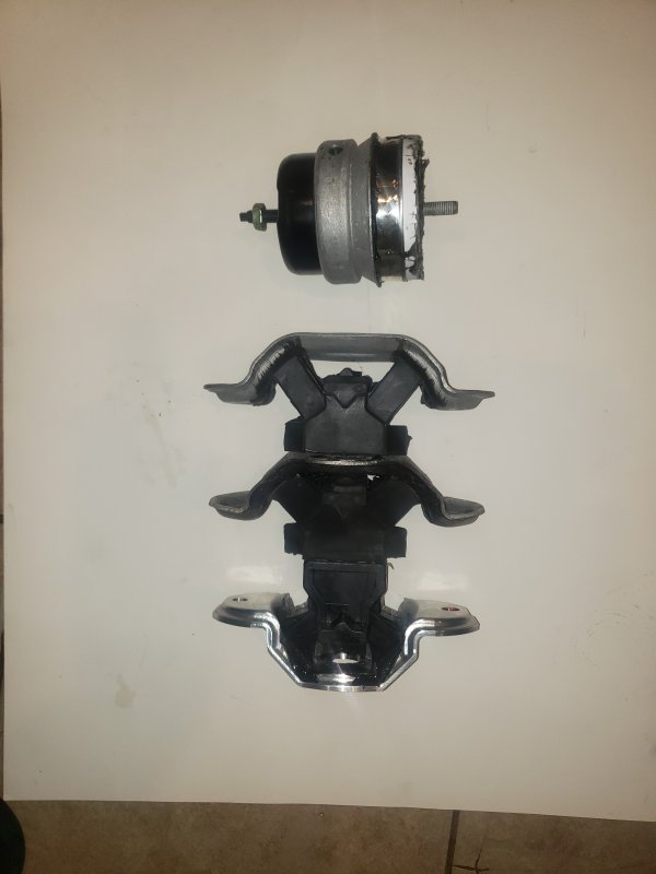

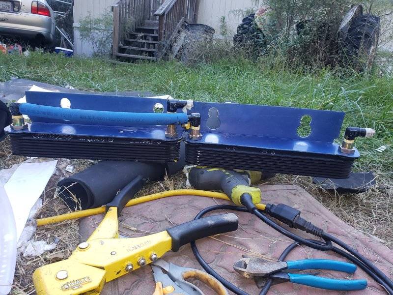

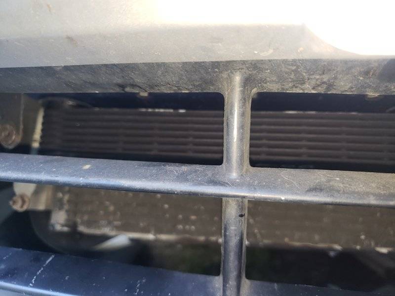

Yes, i have a machinist make three sets on the engine cooling tubes rad to thermostat return and two degas tanks. They are the answer to highway maintenance issues. Currently the thermostat housing iz being made. He also added a reverse cone filled with the same elastomer as the trans mount on the motor mounts that ressemble an AM unit to stiffen the rubber mount, found that one out by accident. The transmission mount plate was machined with a much stiffer carbon fiber infused elastomer molded mount helps insure firm acceleration. The rear roll bar mounts were converted to steel. I haven't had the time to surgically put those in even though a one inch access hole was sawed above the fourteen mm headed bolts. What the real power adder to the wheels is to enlarge the tranny cooler lines to ( DNRCUSTOMS 3/4-16 ORING BOSS ) 5/8" dia thru two F67Z-7A095-BA (11/16-20 )coolers mounted under & back on the internal bumper. These are some of the things i have done with some amount of failure. If you want to contact this machinist let me know.
