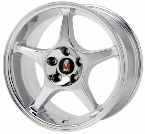

I don't like any of the 5 spoke chrome wheels available for the LS. I like the style that is meant for the 00 Cobra R. Obviously that is a 5 or 4.5 Mustang bolt pattern.

That is not the wheel that I am looking for. I dont like how the spokes curve. I was looking for something like this:
