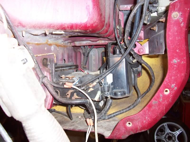

This install could have been easier if I had no air ride but I do. On a mustang there is NOTHING in the pass fenderwell at all. The mk8 has air ride pump,relay,charcoal cannister all in the way.
Here is all the stuff that needs to be moved around to fit 5 inch hose in.
First thig was take out pump and charcoal cannister and trim away part of the basket.

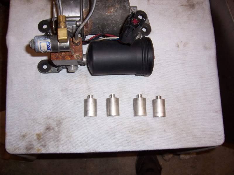

Next I had to machine up new pump feet to raise the pump up 1.5 inches. Here are the feet and you can see the NOS soloniod vent mod I did on the pump years ago when stock vent froze up. This NOS soloniod has been working mint for 5 years now. Its all plumbed in to work and vent same as stock.

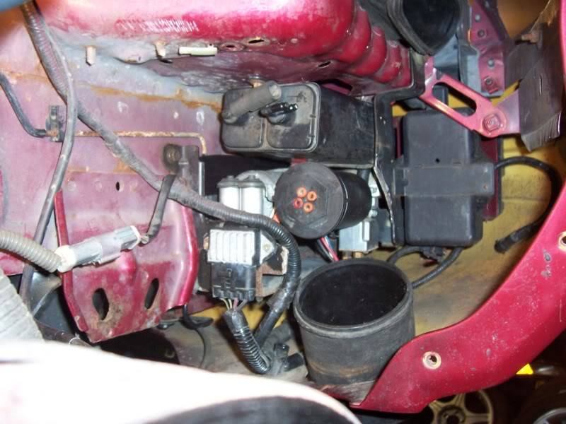

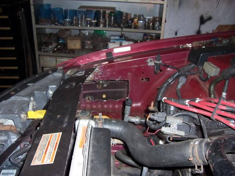

Here is the hole cut out in fender wall and box test fit.
Next shot shows pump raised 1.5 inches and charcoal cannister hung above pump I also relocated the pump relay to back of pump basket. You can see the scoop tube sticking up from bottom now.

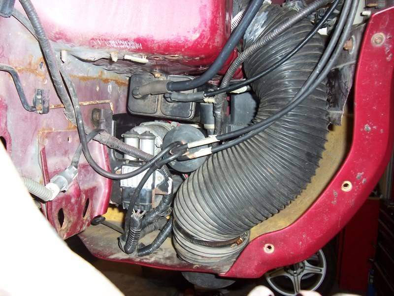

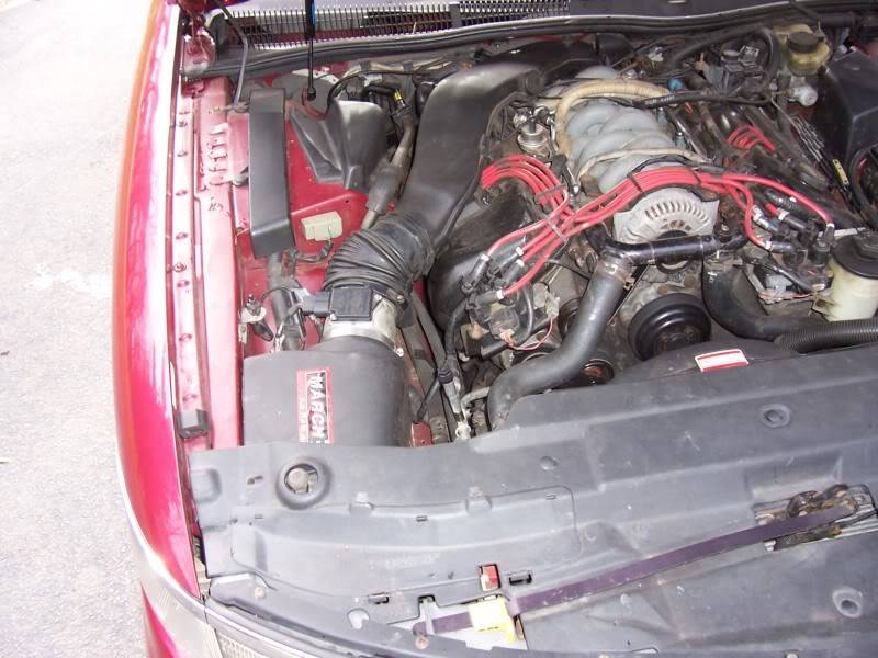

Here is everything hooked back up and 5 inch hose run.

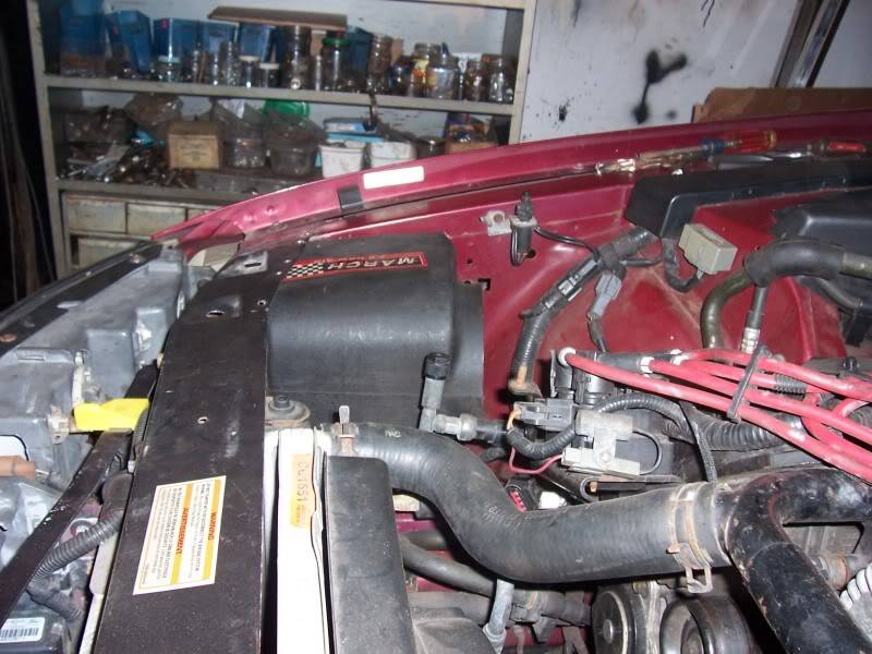

Here is pic under hood all hooked up and ran.

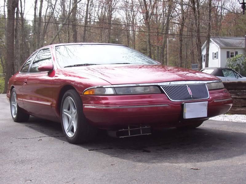

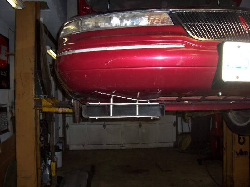

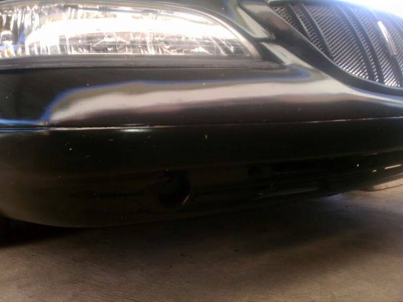

Here is front shot of the scoop all mounted. I surrounded the scoop on alum strips to make it hold its shape better. It got little beat up over the 10 years on my stang.

All cleaned up and ready to go to the track with drag radials on. I will get to see what the headers, full dual 2.5 exhaust, only 1 X muff under car and ram air will do for times.
I think I will black out all the alum so you don't event notice it.
Here is under hood shot with all trim in place. All the air ride works happy about that.
