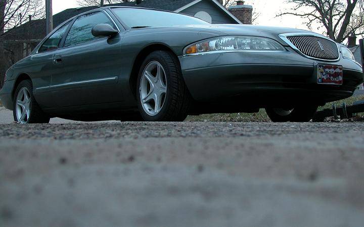

actually i have a set of chrome 18x9 03 cobra rims on my mark and i love them. I did the hub swap grifters right about the 94 and up front hub, but the rear have to be 99 and lower cobra's cuase the newer cobra's have 31 spline instead of 28 spline axles

I wound up buying a set of 17x9" Bullets in Triple Chrome of EBAY. Bolted right up to the front with a bit of interference with the spindle. Have to mount the rest of them up and then my car will look real good with them :D
i think i am into my swap for around $500 for everything counting the GT PBR caliper swap, minus rims/tires.. but all my parts are new parts, if you can do some good scavenging, you could come in cheaper
