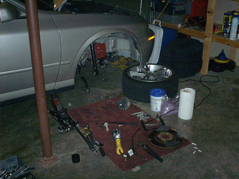

lol. dont give up now! i know wut you mean about the suspension. i more or less did a total suspension rebuild front and rear myself. those wheels on your LS look pretty big and pretty heavy. this could be the culprit. these suspensions are a very good design IMO but they tend to be slightly fragile IMO. since i have gone from 19" wheels with 35 series tires to 18" wheels with 45 series tires, my suspension hasnt had any part failures (could be cuz theyre all new parts also). the squeaks you are hearing could be anything, i'd check into stabilizer bushings, ball joints, or most likely control arm bushings. are the squeaks in the front or rear? have you replaced anything else in the suspension?
