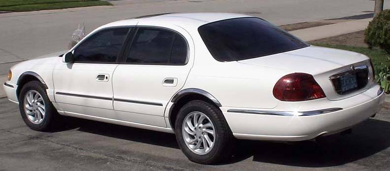

I've just put some 16" Lincoln MARK VIII unidirectionals on my 02 Conti as well as 255-50R-16 rubber. They fit fine and no rubbing on the struts. I like this look and was considering bigger rims but decided to stay with the Lincolns. There are certainly lots of rim pattern options out there and the trend today is for 17-18" for sure. The 5 x 108 BP does limit the choices,
The Bolt Pattern is indeed 5 x 108, Centre Bore is 63.9, Lug is 12 x 1.5, Offset is 32-44 and OD is 26.2ish
