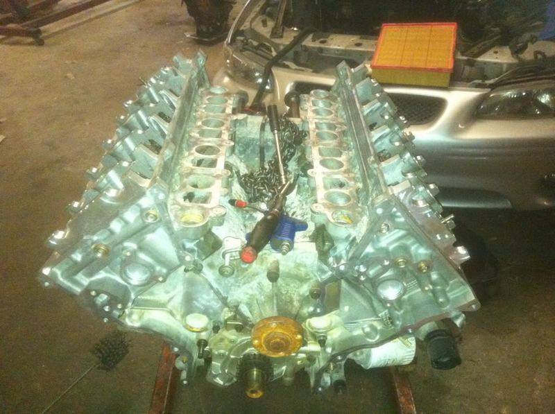

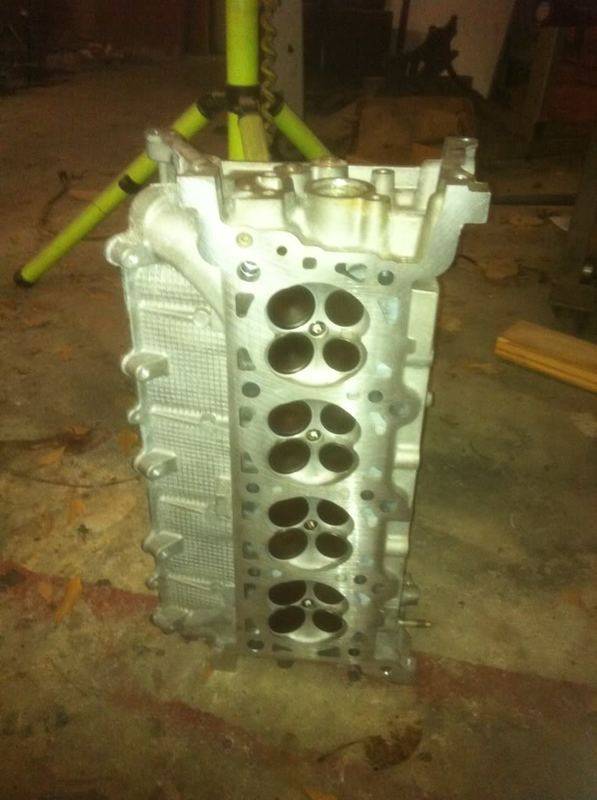

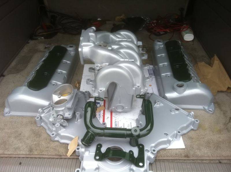

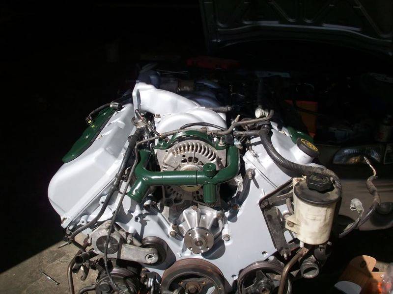

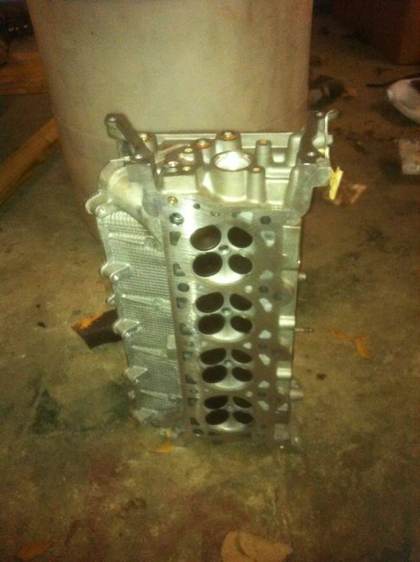

I'm building up my son's 97 Evergreen LSC. He's been stationed in Japan for the last two years, and I am getting his Mark ready for when he comes back. There were some problems with his motor, Cylinder 3 misfire that I couldn't fix. So I decided to build another motor. I had my motor from my Black LSC that burned up, so I took it apart, sent the heads off to the machine shop for new valves, lifters and stiffer springs. I took the pistons out of the block and had it magnafluxed. Then I installed all new Ford rings and bearings, as well as all new Ford gaskets.

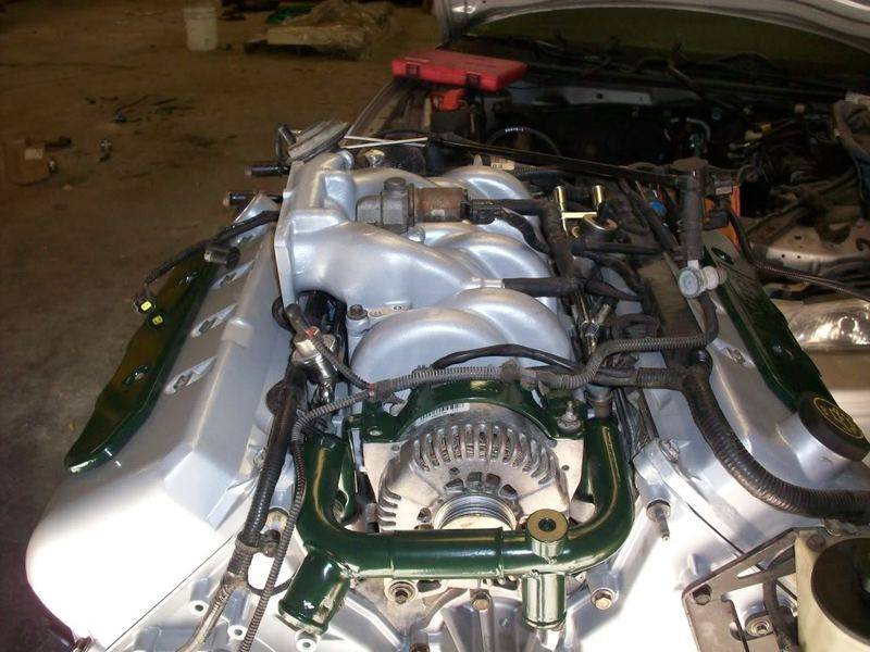

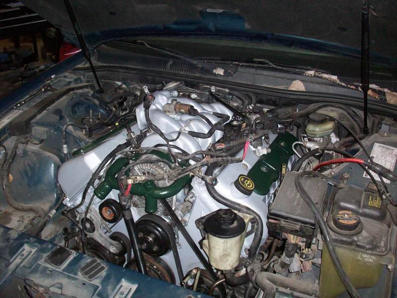

I too did powdercoated valve covers and intake to make the motor look as good as it's going to run.

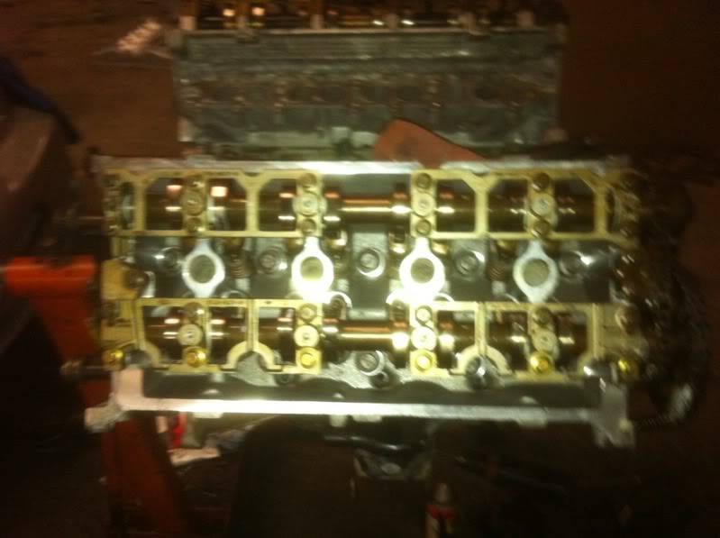

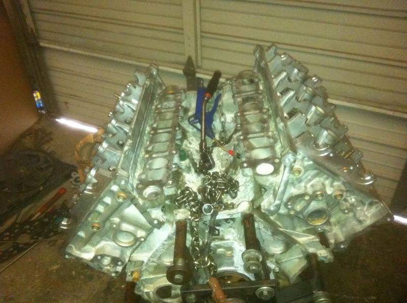

Did you get cam locks?
you sand blasted the throttle body? the parts look great but i wouldnt have touched the throttle body, you cant mess with them, the inside of the bores and butterflies have a special coating on them and when you mess with it you will have an irratic running motor, my throttle body is black but i taped everything off on it and just painted it high gloss high temp black to match my intake, those throttle bodies cant be messed with, i hope you didnt sand blast the throttle body!

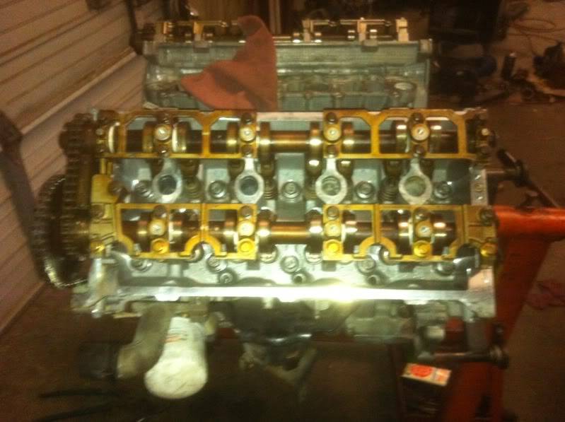

The cam lock tool is what locks the cams in place so you can attach the sprockets without losing the timing. The cams are not keyed to the sprocket and they will move when tightening down the bolts.
No the throttle body is not sand blasted.

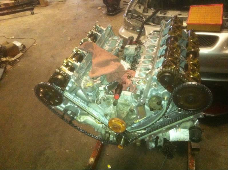

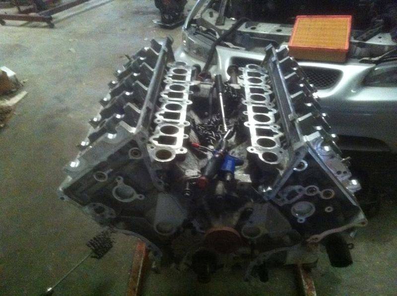

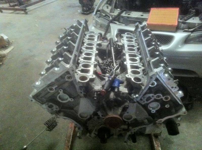

Installing new timing chains, and new tensioners.
Is this what you are talking about Bill. I don't know all the terminology. :)

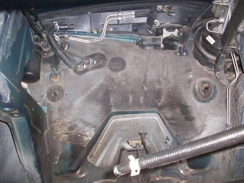

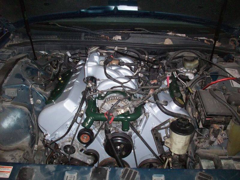

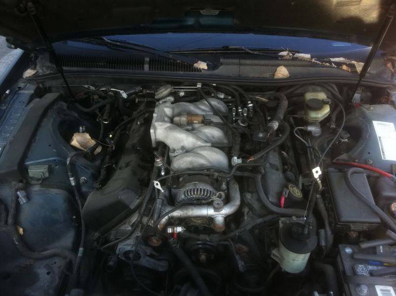

Got everything unhooked from the car, I'll rebuild this motor next later this summer.
I dont see any tool there to lock the cam in place. How did you time it?

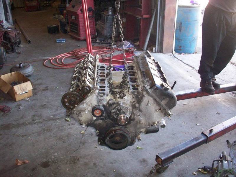

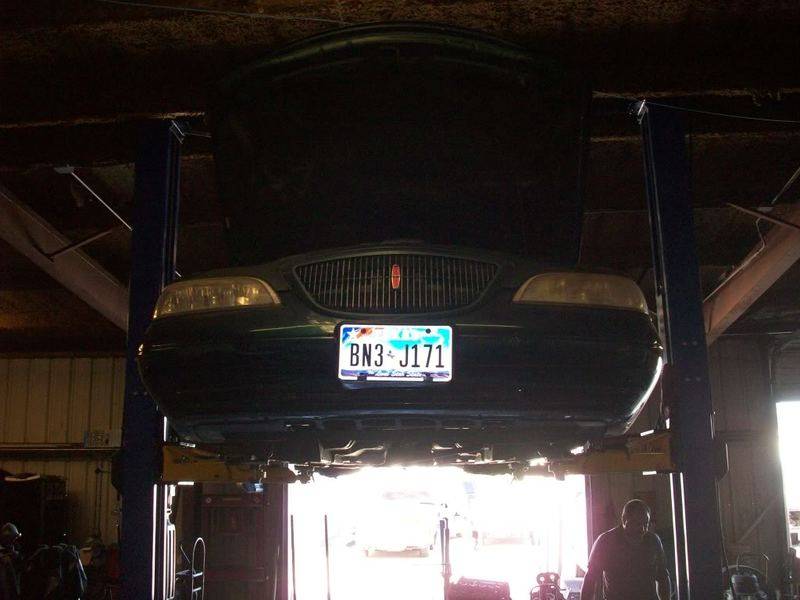

Out With the Old

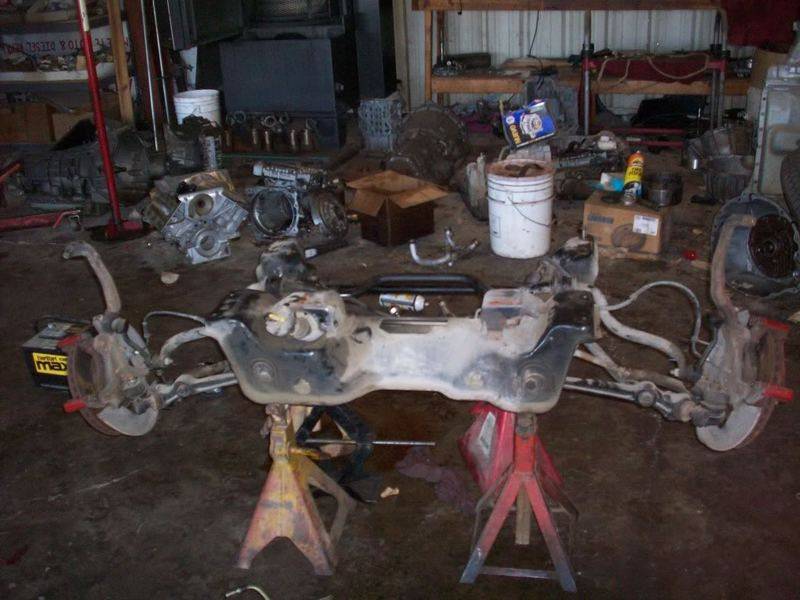

The old motor from my son's Mark was removed today, ready for the new motor.

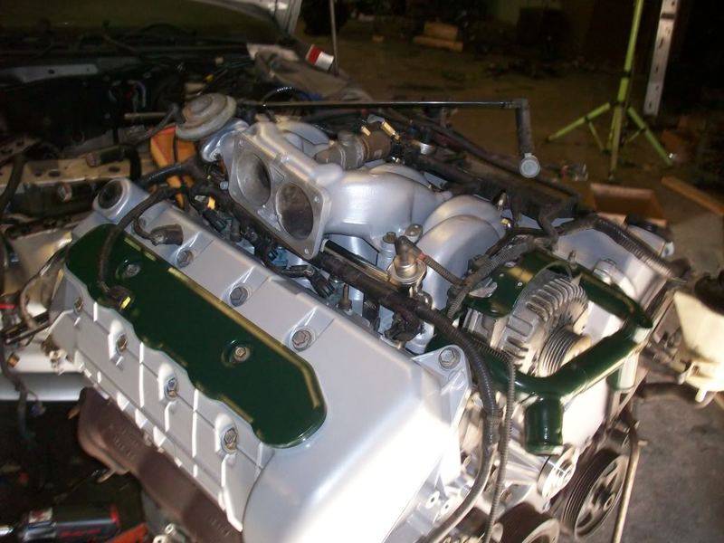

An the new motor stands by waiting to go in.

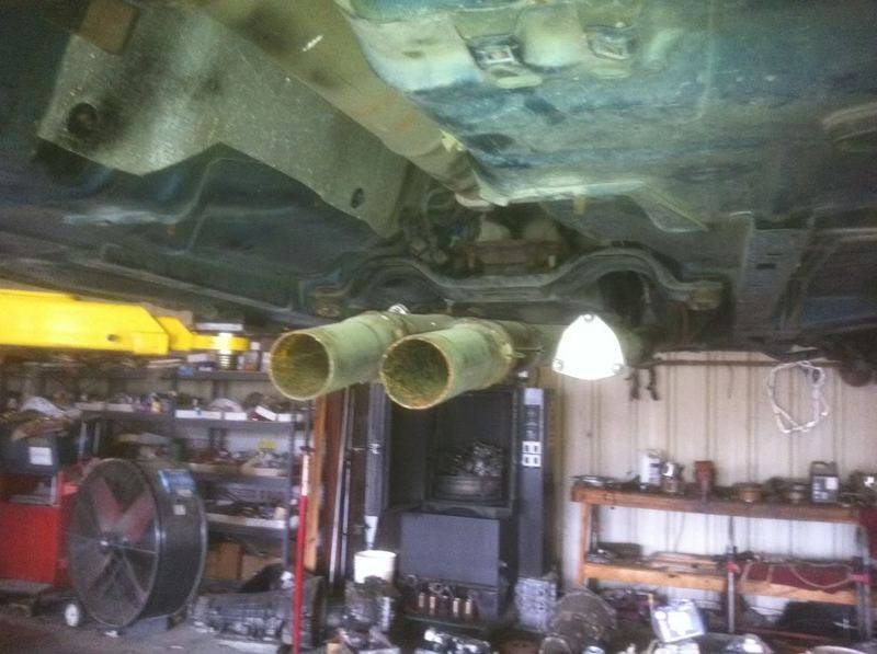

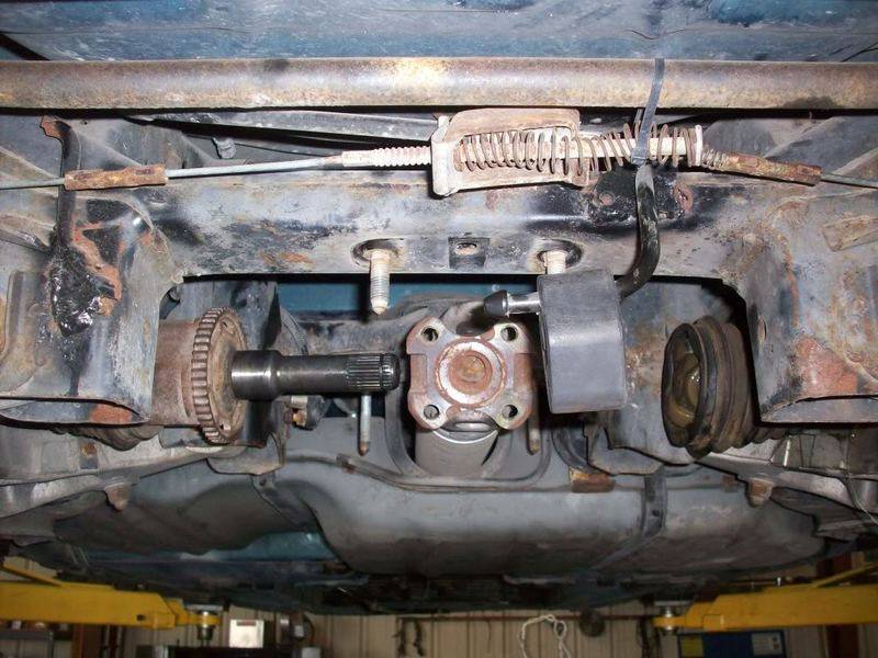

Last but not least, preparing for 3.73's and trak lok

back on topic LOL, Great looking engine! love that color scheme!!
Thanks guys. I want my son to have a nice car when he gets back in a few months. Everything new is going in. Starter, all gaskets are Ford products. Should be a clean running car.
that is awesome some day I am going to hand my Mark off to my son and my convertible off to my daughter....I look forward to the day I can hand them the keys saying they deserve this....your son is going to be glad to be home...does the green represent the Army? are you putting headers on the car?
