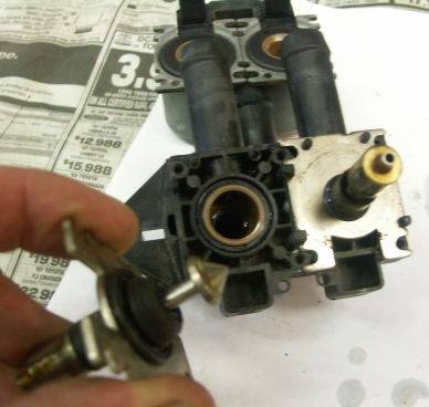

Likely, however more so the fuse continues to blow as the internal Climate Control chamber solenoids are stuck. Coolant is a corrosive material, eats and gums stuff up. Entire cooling system suspected to be of same status.
DATC currently has it instructed to move, which it can't.
Removing the electrical would stop the fuse blowing.
Climate control is ON, start car, fuse blows.
more: DCCV Disassembled Views
