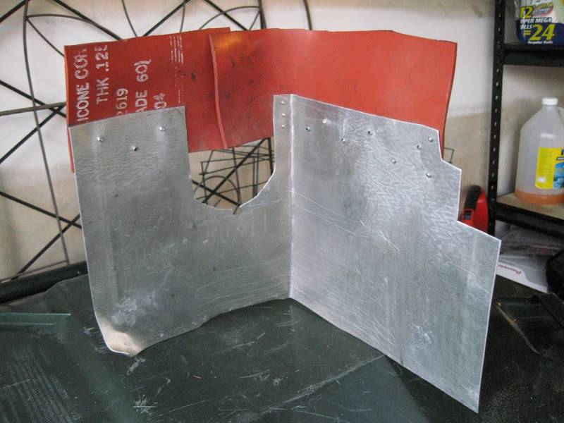

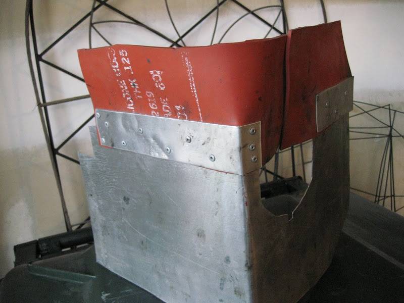

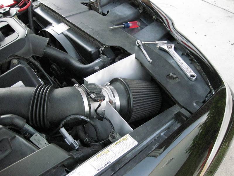

So, like 4 or 5 years ago, I got ahold of some spare sheet metal at work and came up with this really quick. It's really crude, but it got the job done, and it was free!
*Now, I know a lot of you don't like the open element filters.....I don't really care. I like the way they look and I like the way they sound too.*

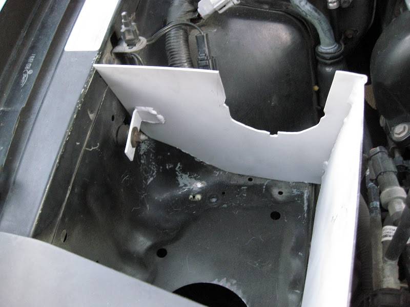

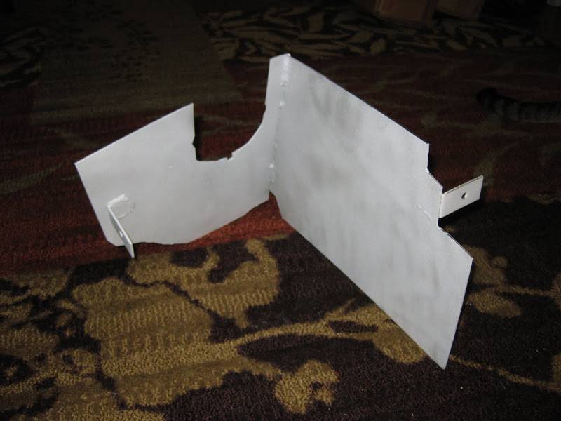

Anyway, I made that with the intention that it would be sort of a template for a future, more refined version. I had also planned on cutting that rubber stuff to the contour of the hood. Well, almost 5 years later, I still had it on the car. The other day, I decided that I would try again. I must say that this one is a much better attempt at it, but is still in no way a finished product. This time, I made it from 2 pieces of aluminum and then welded them together at a 90 degrees. It took a whole bunch of trimming and fitting and trimming and fitting, and finally go this...
Instead of just sitting in there where it could move all around, I welded tabs to it to use the existing stock airbox mounts.

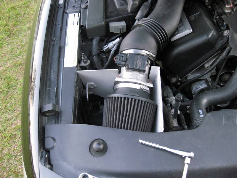

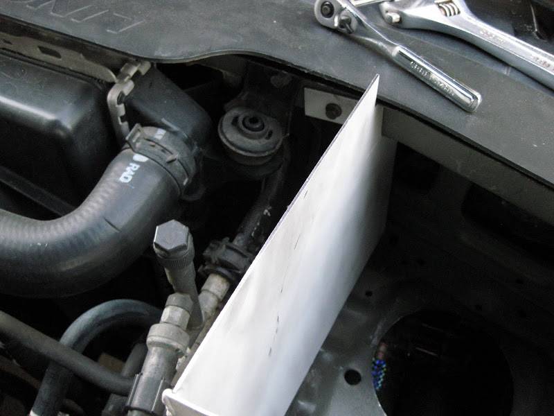

And....here's how it looks with the MAF and air filter installed. I still need to figure out how to line it up to the contour of the hood and seal it off from the rest of the engine bay. While effective, I don't think my first attempt with the big, stupid, ugly orange rubber turned out very good looks-wise. Once I figure out the best way to do that, I'm going to make another one out of some thicker aluminum and then probably get it powdercoated or something.
maybe weather stripping on the top and around the dip where the intake goes in.
Actually, I was just talking to my wife about it, and I think I'm gonna try and make a cover out of plexiglas or acrylic. Got lots of it at work.

Well, obviously, if I were going to make and sell them, I would have to call them something else, so as not to step on Geno's toes, but I really don't think he would mind that much, seeing as he hasn't made/sold any of his Ice Boxes for like 5 years or so. And seeing as I'm not sitting here copying his design, I don't think he could care.
If there was enough interest, or if I happen to ever get a butt-load of free time, I might consider getting this drawn up on the computer and cut out on the waterjet. I would have to get a much more refined product before I consider selling them though.

I bought an 80mm MAF adapter (can be found cheap on eBay), and cut up a PVC pipe rubber sewer adapter to fill in the gap between the MAF sensor housing and the intake tube. I went to JLT's shop in Virginia and this is what they came up with since all of the mustang stuff was different. Cost me $60 for the filter, the adapter and the sewer pipe adapter.
